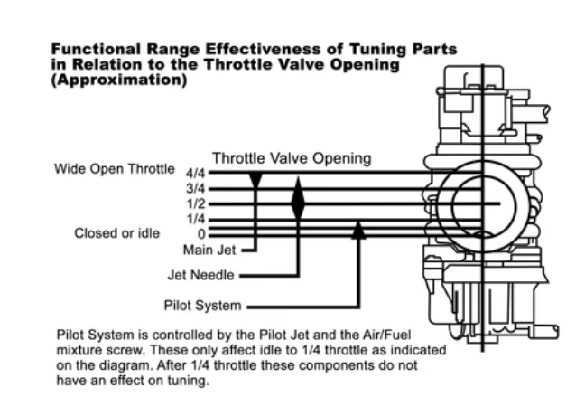

I would have thought main jet could be your issue based on this:
