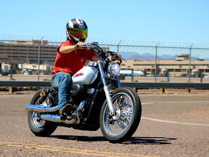

2001 Spirit 750
  • Hey Everyone! My name is John. I bought this spirit 750 3 years ago, and fell in love. Ive had some issues getting it to idle smooth. Just figured I'd come one here and do some research. Im excited to join this community and learn more about bikes!
