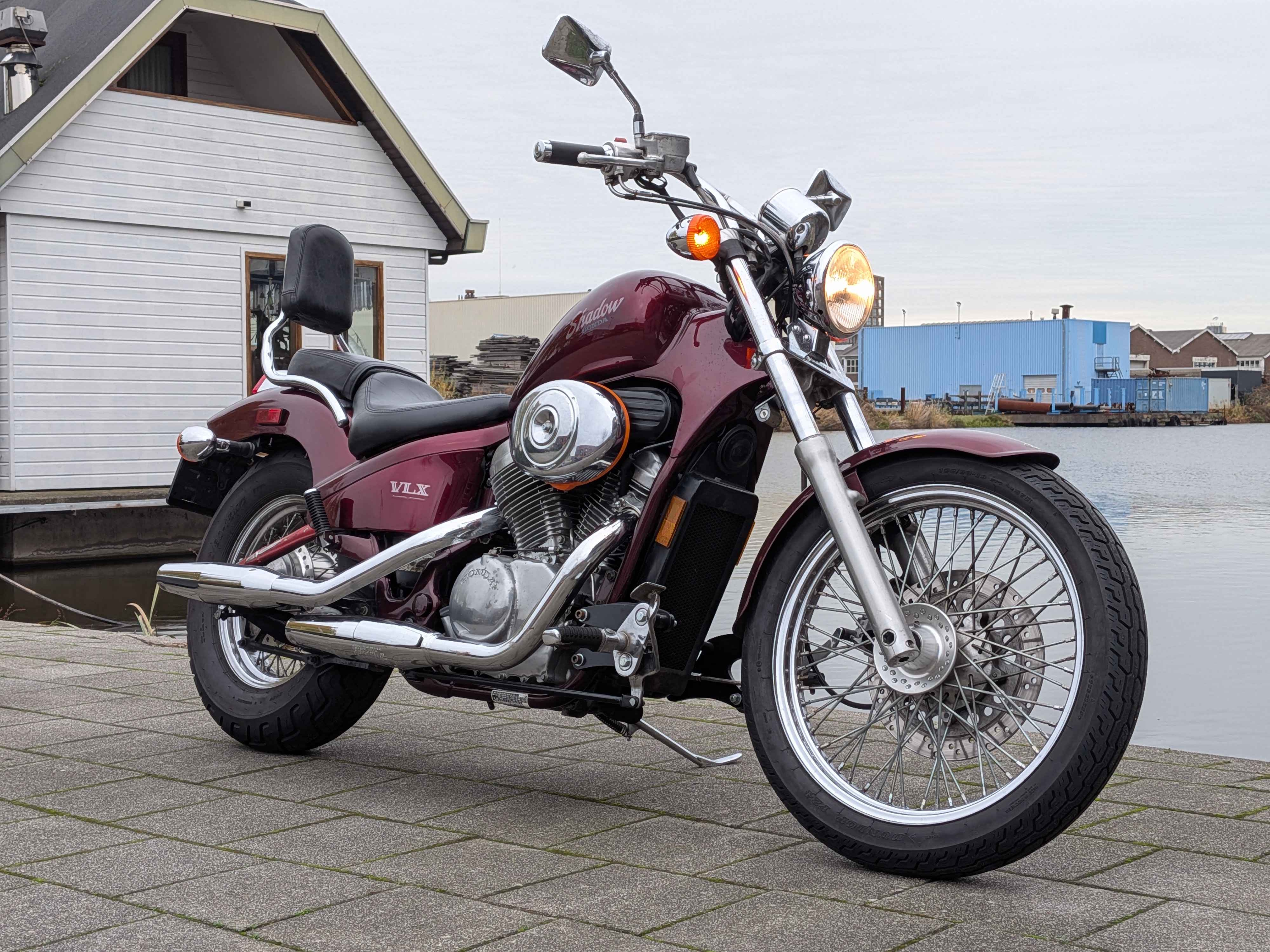

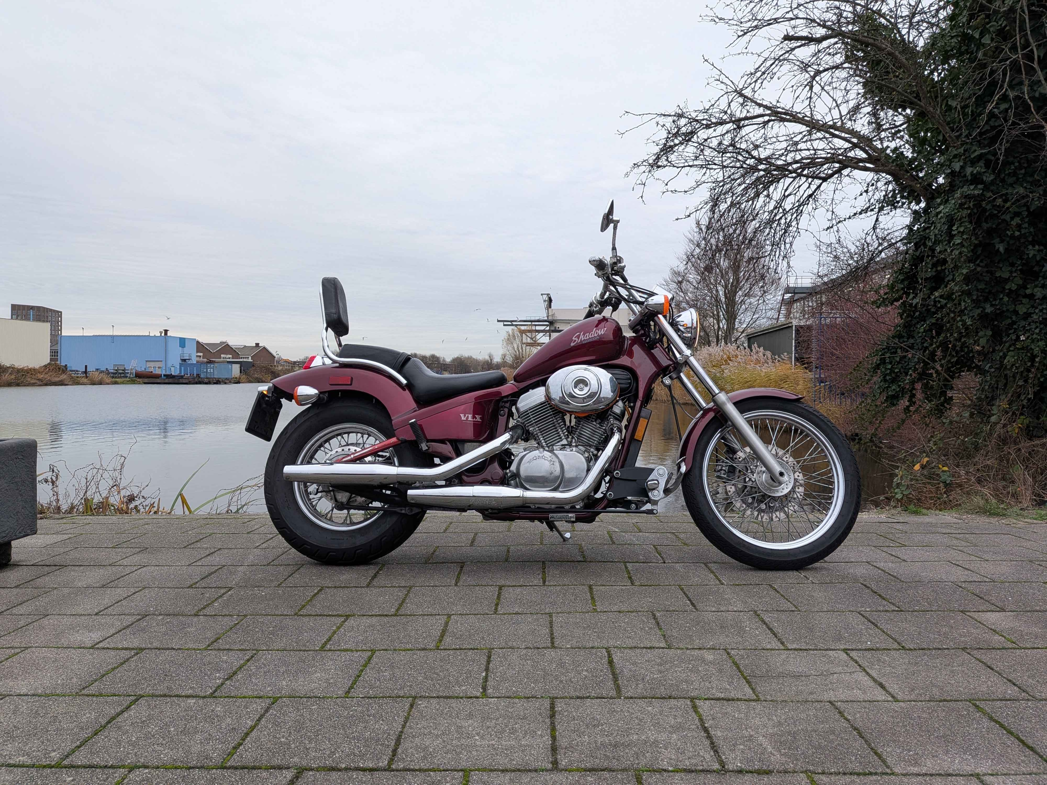

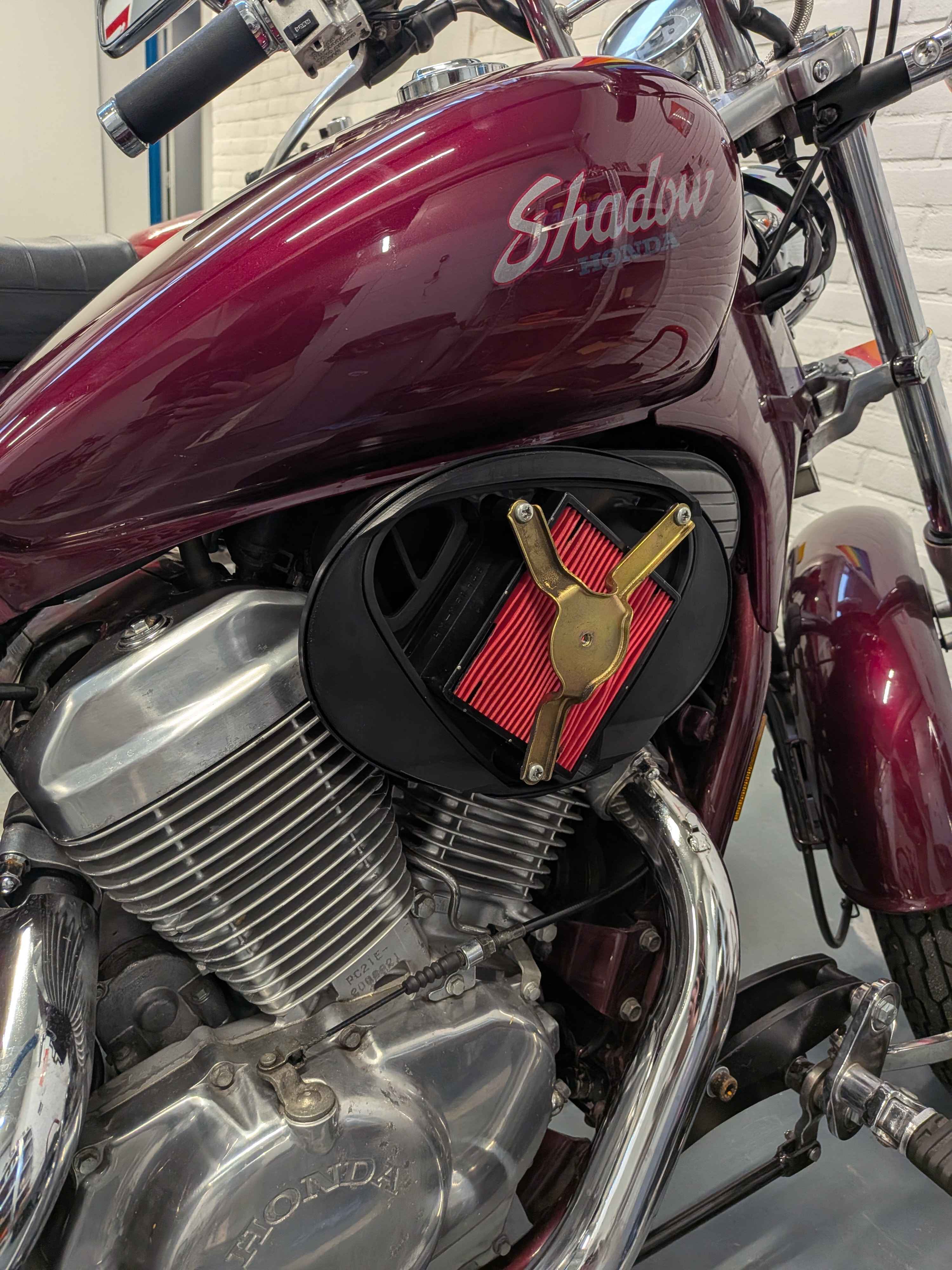

  • So, like the title reads, I made an adapter to fit a HD Electra glide Screamin Eagle air filter cover on my shadow 600.
    WHY?! I hear you ask, and honestly... good question haha.
    I honestly did not like the look of the original triangular filter cover, and managed to snag one of these covers for $4 online.
    This also doesn't modify the original airbox, so the jetting and carbs remain untouched (for now)
    I'm still in the process of designing a new inlay for the cover, as I didn't want the filter to read "Harley Davidson" as that just didn't seem right.
    I have released the STL files for anyone interested here: https://www.printables.com/model/1512804-hd-filter-cover-for-shadow-600
    Some Photos:
    Part printed in orange for better visibility in showcase photos.
    Finalized part printed in a heat resistant material:
    That's all folks!
