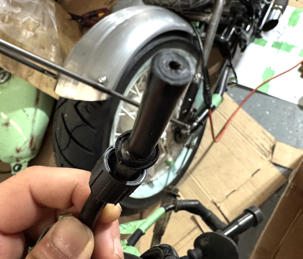

  • hey man @TJ Brutal
    awesome - another question though - using your ignition wire, how do I extend it? just cut the original cable above the cap that goes to the coil, then patch there? Because not sure how to "reproduce" the part that connects inside the coil
    thanks!
  • @Marcelo Pham watch the video dude! shows you how to do it - https://youtu.be/_U0XheccdJE?si=axVzu0vT9bnhCq50
  • @TJ Brutal  oh man I missed that video, thanks!!
  • no problem @Marcelo Pham i got you!
