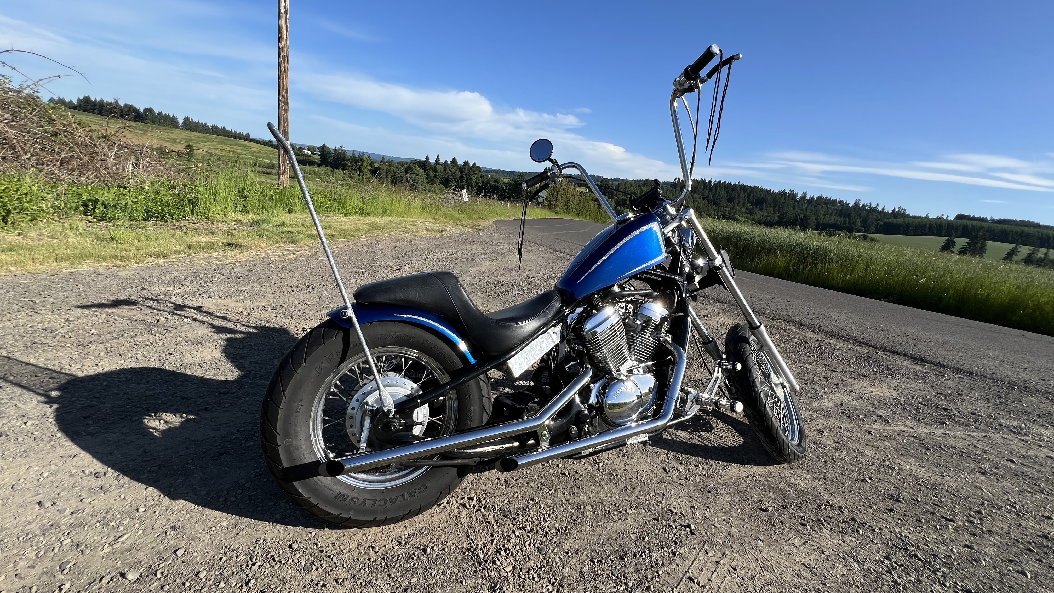

  • I had to get super creative. MIne is a Mustang installed on the stock bike. Made a custom bracket from the original mount, running down to tabs. Bolts welded to the fender bracket thread end up. Fender slips over the bolts, then the seat bracket, Tighten down with nuts. If the nuts ever loosen, Nothing falls into the tire. Down side is, it takes time to take the seat on/off because of the tight space. Also had to trim out the back side seat fiberglass to allow a tighter fit against the fender.
