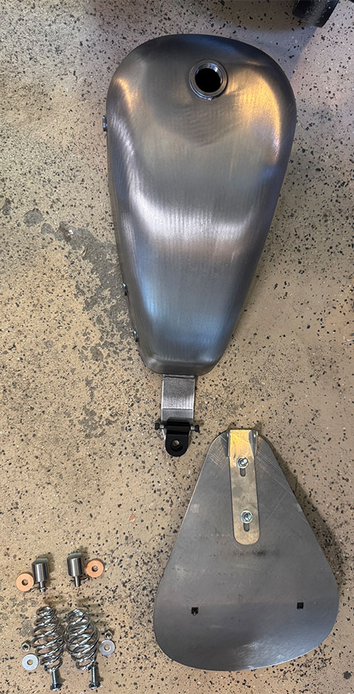

TANK
(1) I see I need to drill out the front of the frame for the tank's larger bolt, and the rear bolt just threads into the frame.
(2) The hoses for the tank, I'm confused about. Any videos or diagrams for that?

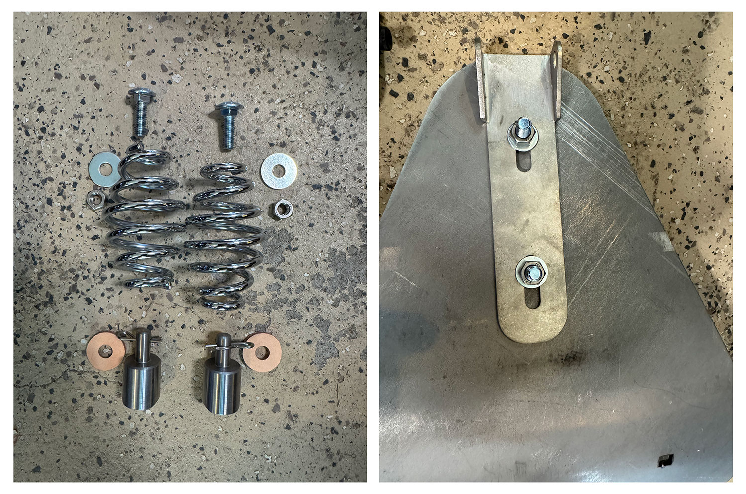

(3) The seat seems to go together like this, pictured: bolt through seat, into spring, held on by washer and bolt. Spring sits on leather washer and connects to small studs, held in with cotter pins.
(4) Those small studs are welded down to a support bar on the frame.

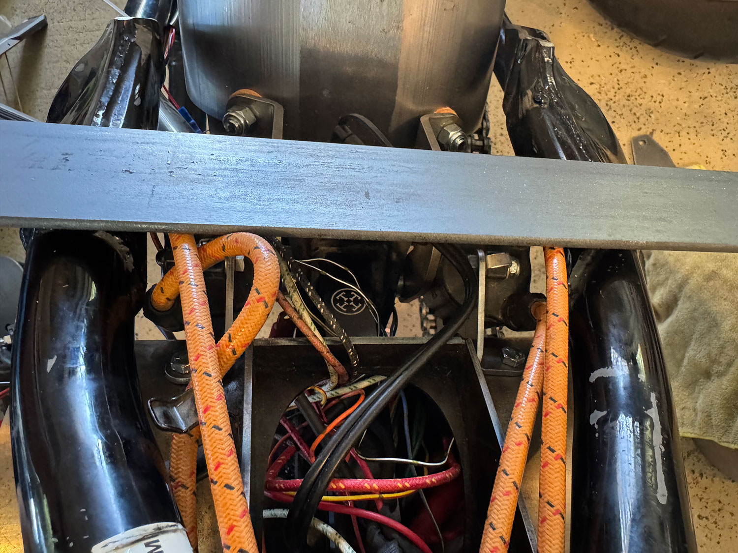

(5) The bar I cut down and weld to the frame seems awfully close to the coil's ignition wires. I'm guessing that's fine, but changing them out in the future will require removing the coil brackets and coils (which is fine, if that's how this all goes together).

I've tried guessing on the tubing, and have mounted the gas tank like this.
I worry the petcock is a bit exposed and the fuel filter is touching the top of the engine. Also, the intake to the carb, I fed through this area which I worry will get too hot (shown below).
Any thoughts? I realize I can do whatever I like with my bike, but as far as you designed these couplings and hoses, am I close, or is there a better way?
@Bry Guy 007 you have the tank lines all routed correctly! there is room for creativity but yes. this all looks great! as for the seat, i run the coils ignition wires coming out in a downard direction when i mount the coils and the power and ground wires go to the top, i would recommend getting a piece of round bar as a support for the seat spring posts. cutting fishmouths on each end and welding the tube in, then setting your seat where you want and then angling the seat spring posts on the round seat support te get the right angle so the springs dont go all wonky when they compress. you want the seat spring post in line with the seat pan bolts basically. looking good dude!
