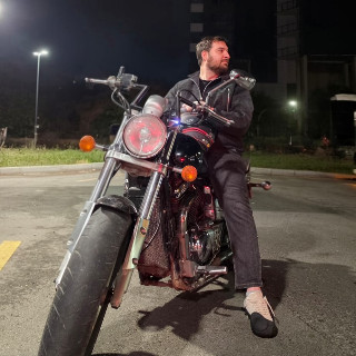

I’m a new rider and recently got my first “real” motorcycle: a 1999 Suzuki VZ800 Marauder.
I’m not planning to customize it heavily, but I do want to make it more practical and safer. My main concern right now is the front brake performance.
