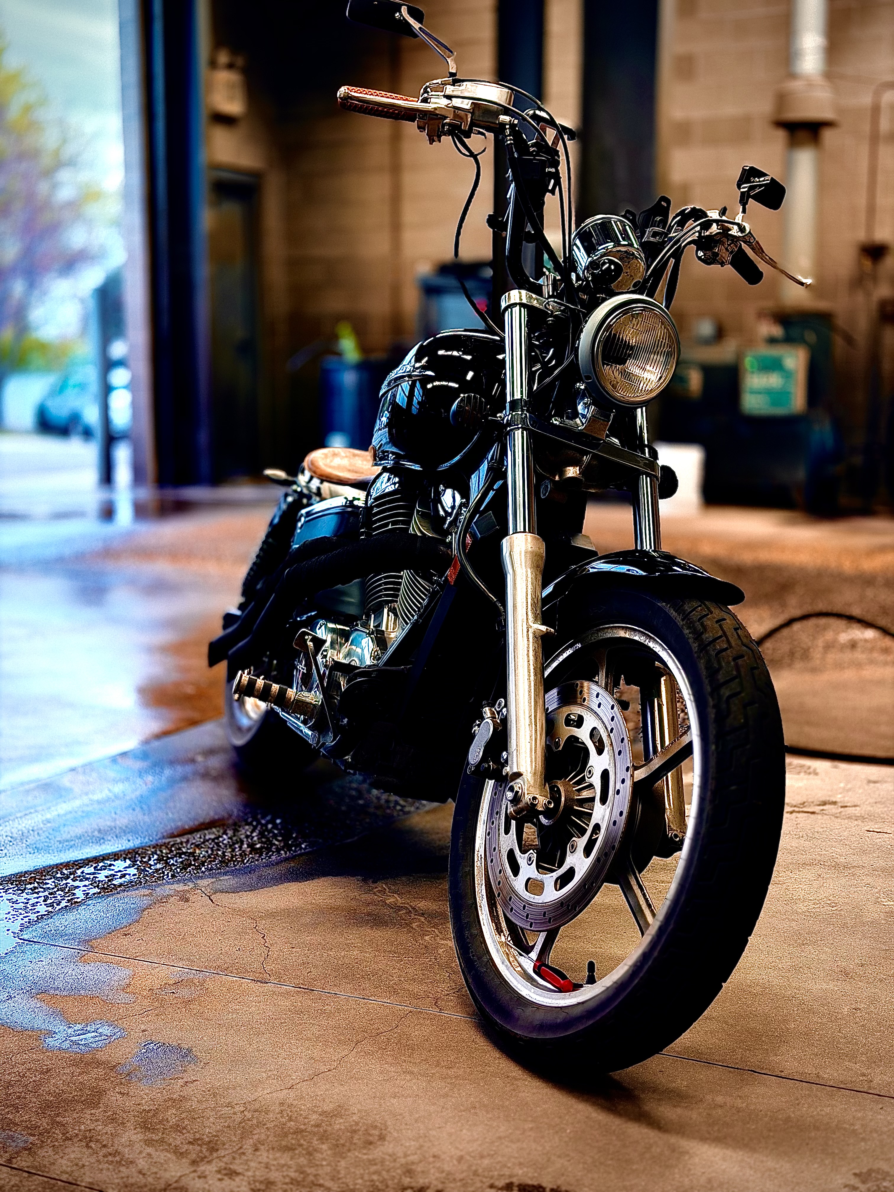

  • I got an 04 Honda shadow 1100 and I got velocity stacks along with the complete performance carb rebuild kit also it's got an open exhaust and I've got the size 200 main jets and the size 50 pilot jet in the carbs and the air to fuel screw is turned out 3 3/4. I'm still getting a lag in third gear and I need some tips and advice on getting this figured out, thank you.
