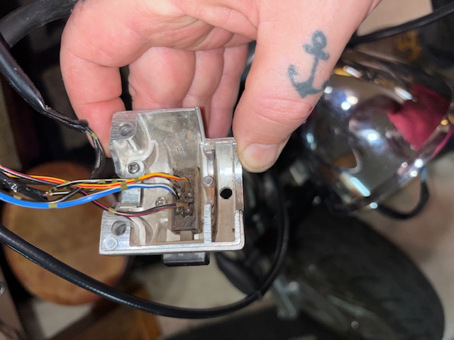

Hi TJ,
I've purchased the Black Box Kit and a chome start buttom from you. I'm planning to locate the start buttom on top of the headlamp housing and bypass the kill switch. Now that being said, I've watched all your videos on the how-to and i get the basic concept. Yellow/Red for the start. Black/White & Black/Green together for the kill.

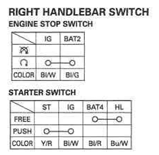

My question is that I have 3 extra wires coming off my oem start button that i just plain don't know what to do with. I've reviewed the service manual for this model and i'm just looking for some guidance please before i go cutting wires.
Black/White = IG
Black/Red = BAT4
Blue/White = HL
Any help is appeciated!
Stay Brutal!
