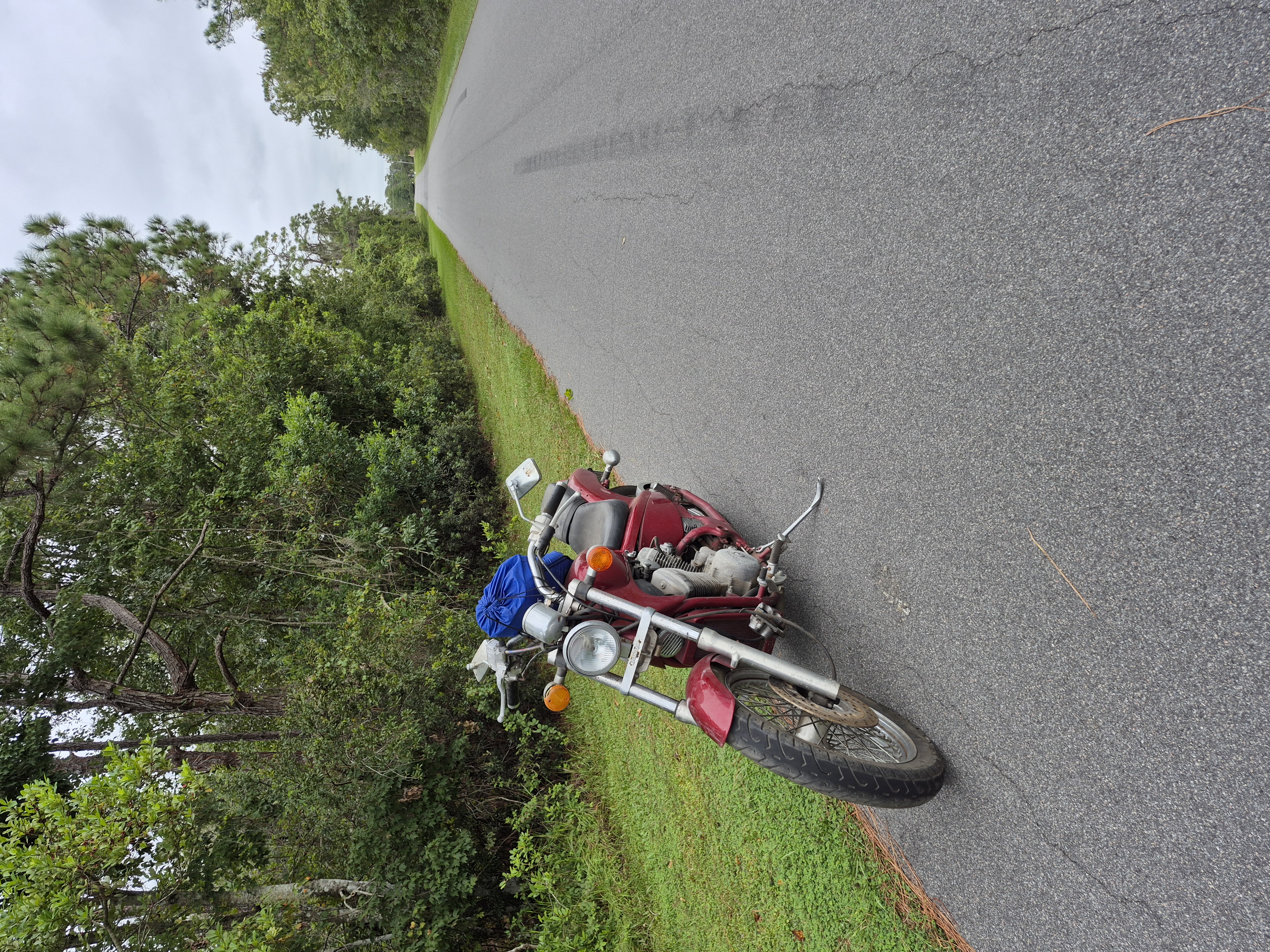

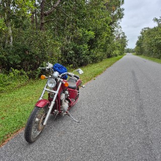

  • I just pushed this bike 5 miles home and well I need some direction, no brakes, shifter linkage is off, no battery, tank has some rust, wheels are lil crusty but im motivated. I have no idea if she'll run and the title is lost. I know I have a lot of replacing to do but what should I immediately do to get her running reliably? Is the stock carb junk? Any emissions bs i have to cut out?

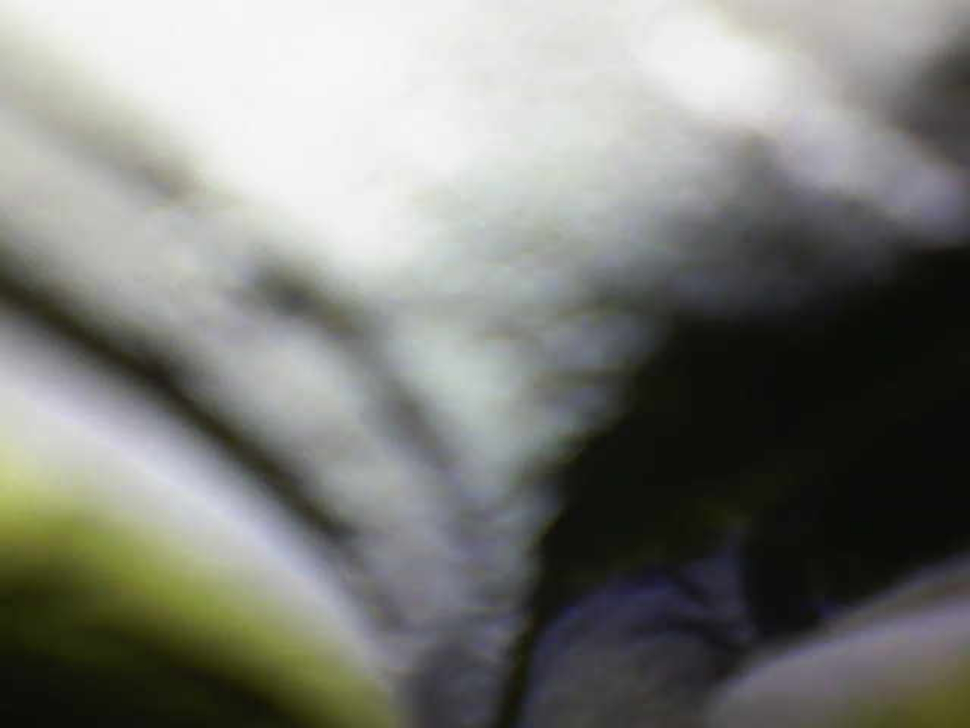

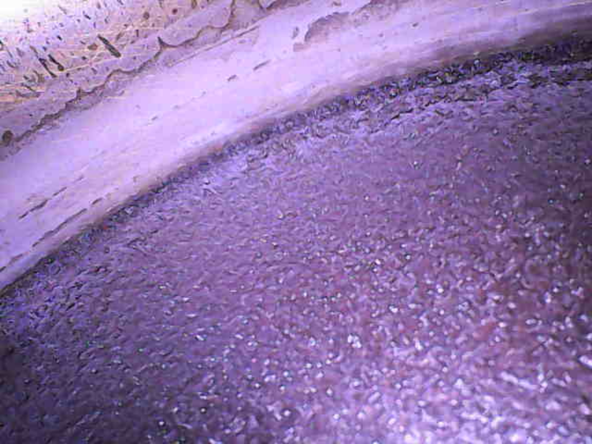

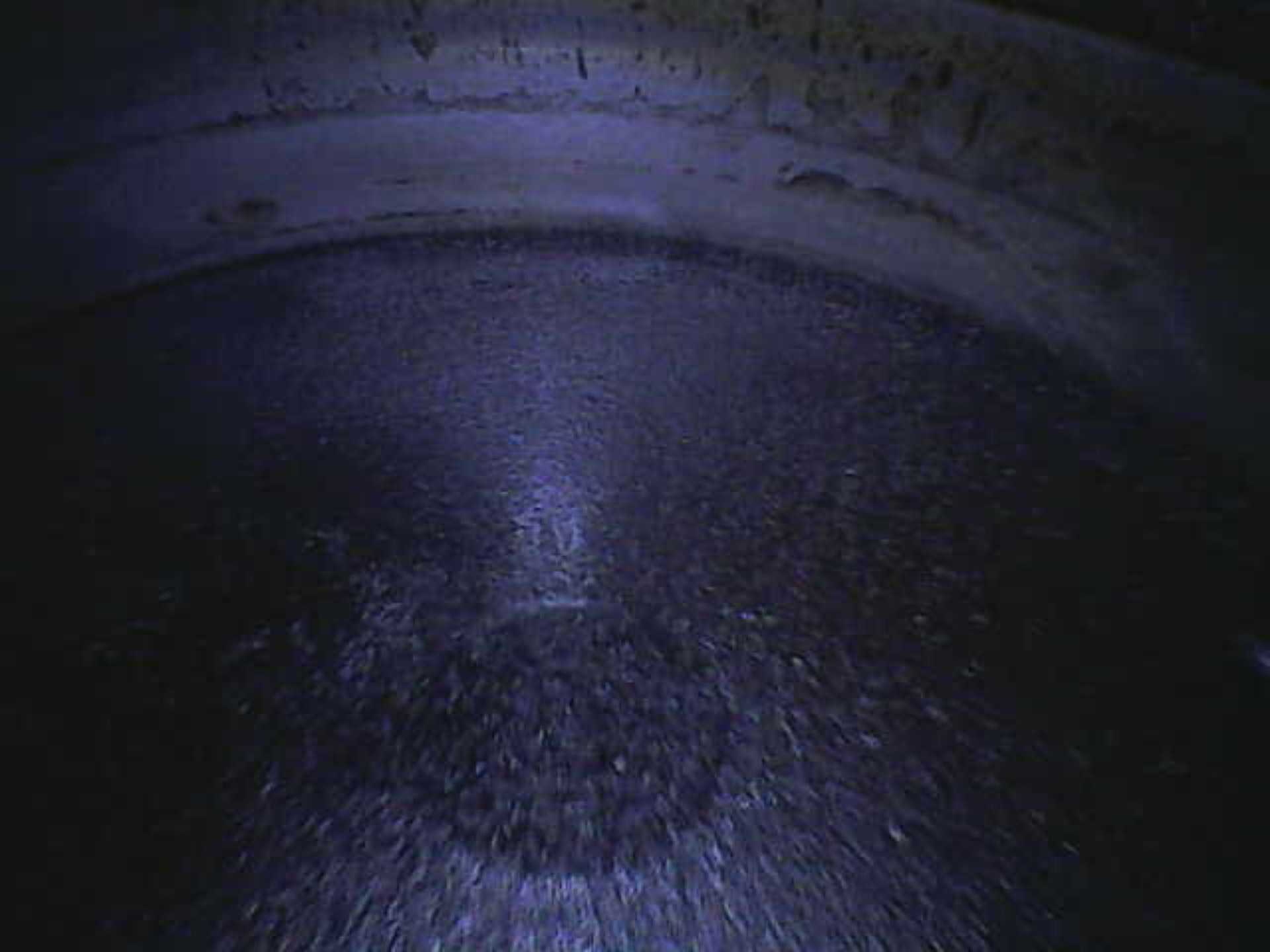

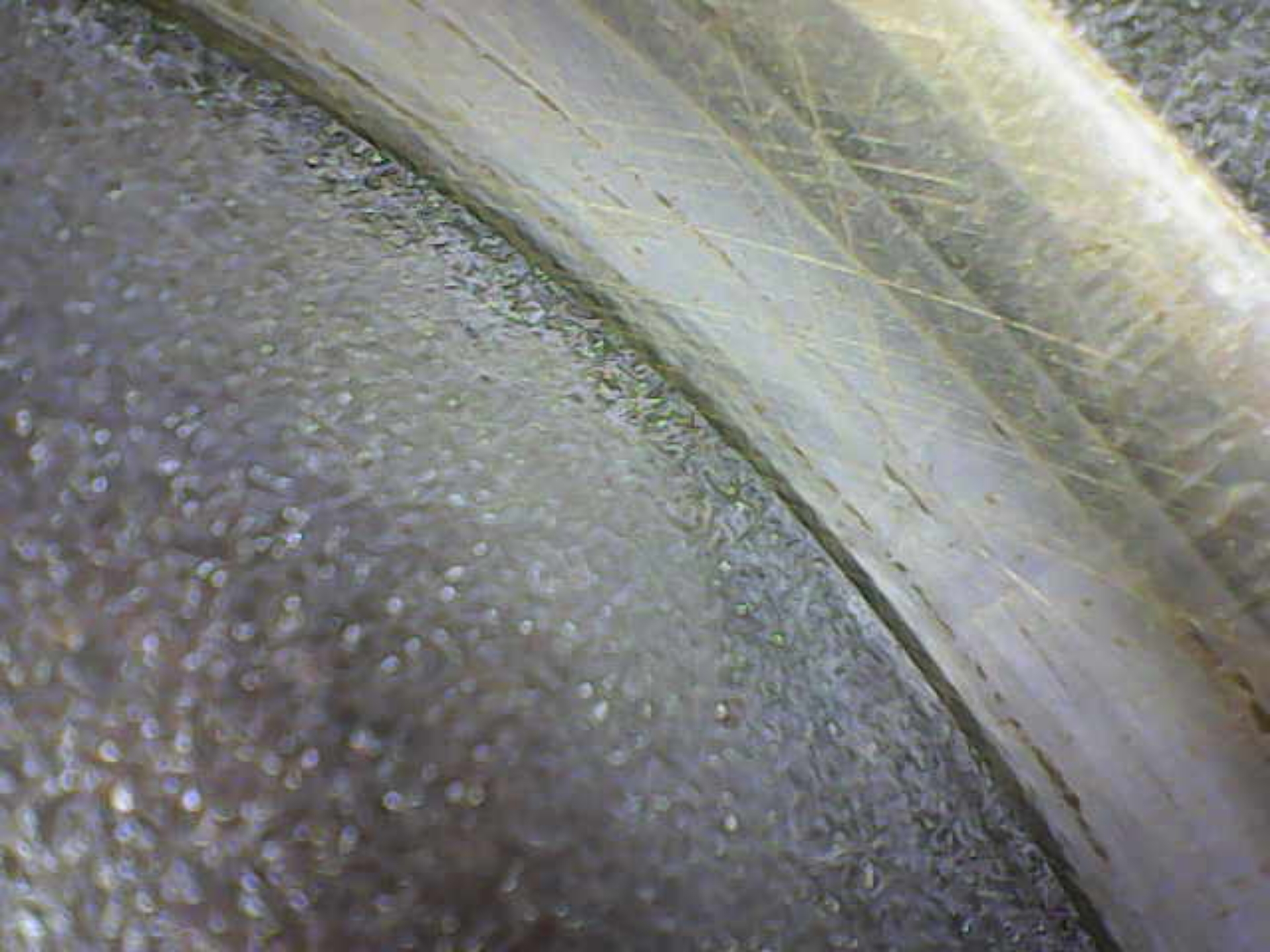

    But I ordered The bore scope and it is on its way, so ill post the pictures here tomorrow once I get a look inside and go from there.
  • @TJ Front cylinder
  • @TJ
  • @TJ
  • @TJ
  • @FloridaNomad sounds good man! yeah its hard to chill when you get excited LOL lets us know what you find!!
