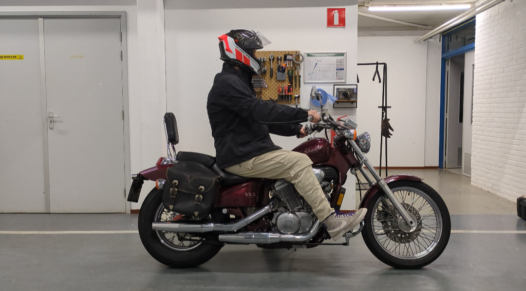

    As a fellow 6'3 200 (ish) pound fella  I can say that in terms of fitment in it's stock configuration it's gonna be a big fat yesn't.
    The stock "cockpit" is a tad cramped as the footpegs sit a bit too far back and up causing your knees to sit above your hip level at an uncomfortable angle.
    The 750 might be better, however!
    I recently installed 6" forward controls and the fitment has been utterly fantastic.
    The comfort went up tenfold and it's been smooth cruising for a good 600+ miles already since installing em.
    Picture of me on my VLX600 with the forward controls:
    With the kind and queen seat you may be sat back just far enough to make things bearable.
    But as with any hardtail don't expect comfort to be it's strong point compared to a more stock/tailored setup.
