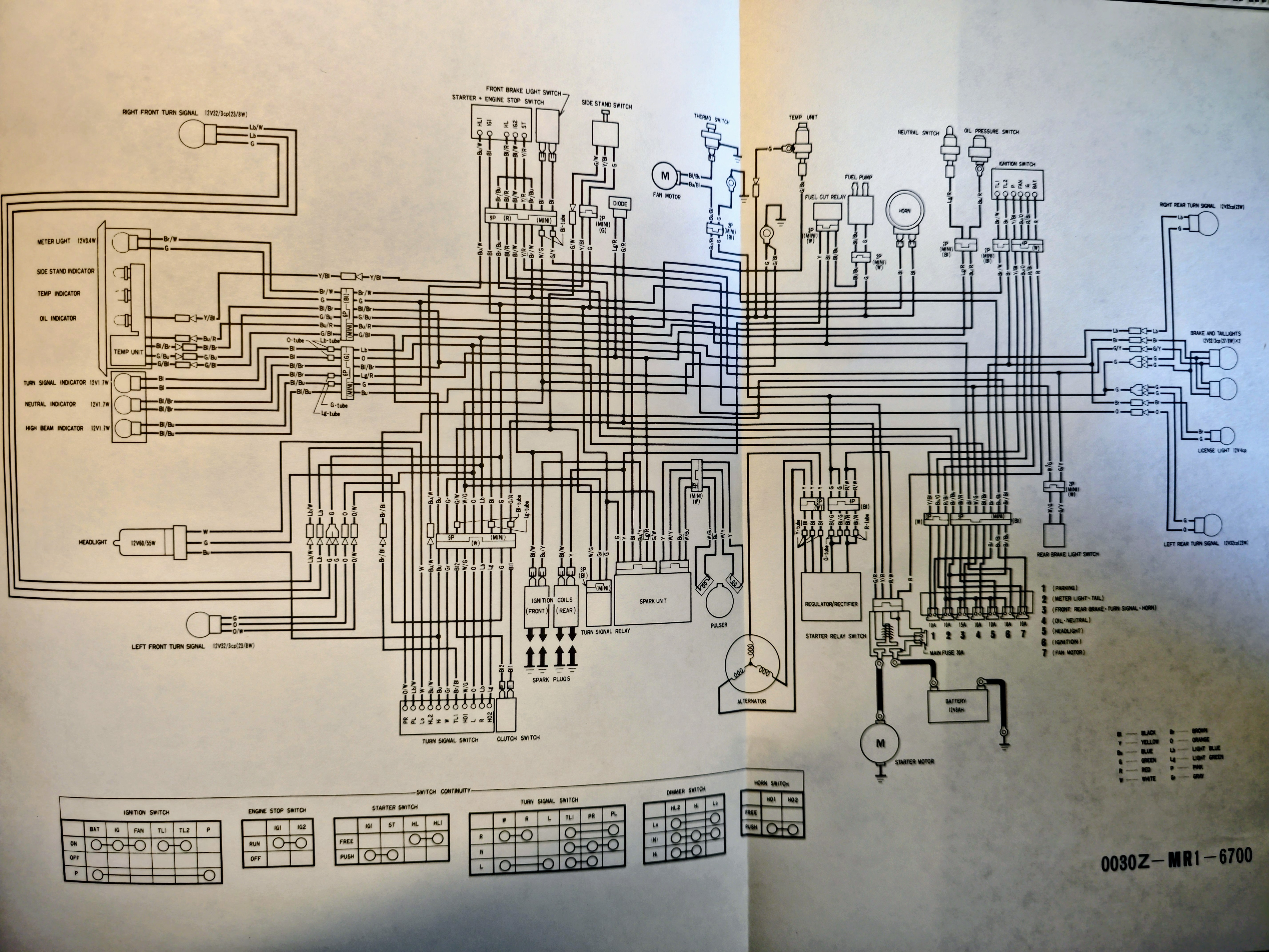

How To Replace A Honda Shadow Key Switch With A Toggle i like the videobut my problem is i have a 1988 vlx 600 which has 6 wires brown/white , brown , yellow/black , blue/green ,
red/black and red and i like to replace it with a toggle switch.

@das chris its the same concept. you'll just need to look up the wiring diagram for that year and youll see what each wire does.
@das chris i have an 88 service manual ill try and get a picture of it for you and post it here.
i have followed the wires and red to starter relay,red black to fuse,blue green also to fuse,yellow black also fuse,brown brake tail light,brownwhite to meter light.so how do i connect to contact.
@das chris
@das chris if you right click that image and open in a new tab, you can zoom in and out and see the wire colors and follow the paths, that will tell you what ya need to do to make things work. sorry it took awhile i had to figure out how to get an image so you could actually use it LOL
