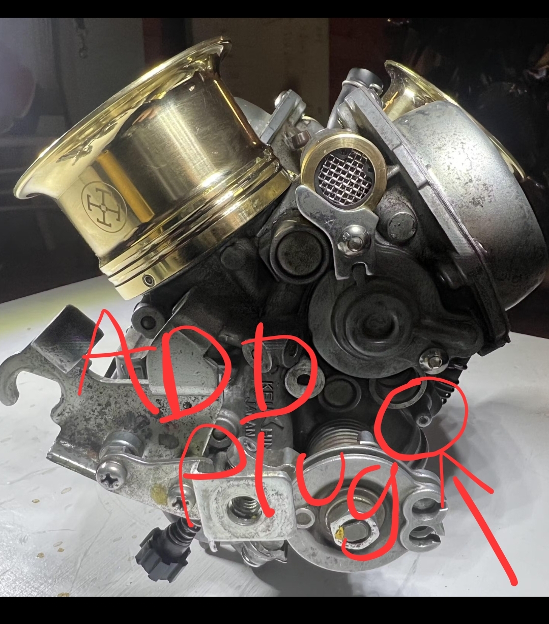

  • @Florian Rädler Hi Flo, I had a similar Issue. My problem ended up being I had the Wrong Vaccum Ports Plugged. TJ Sells a Vaccum Plug Kit to plug these ports. However I had accidentally Plugged the two Top ports as seen in (picture.1) and left a Vaccum port on my rear carb (picture.2) Wide open causing my rear cylinder to run super rich shooting black smoke out the rear exhaust and smoke was burning my eyes and smelled of unburnt fuel. TJ has a video that shows all these Plugged in the correct order. THIS HELPED ME it's under his Playlist (Dual carb videos)  video title: Honda Shadow Dual Carb Secrets- Revealed! Just Pay attention to where he plugs things and doesn't and compare to your carbs. Hope this helps!https://youtu.be/S6o2wOMUbbo?si=qJYcufJ6jZevBdMK
