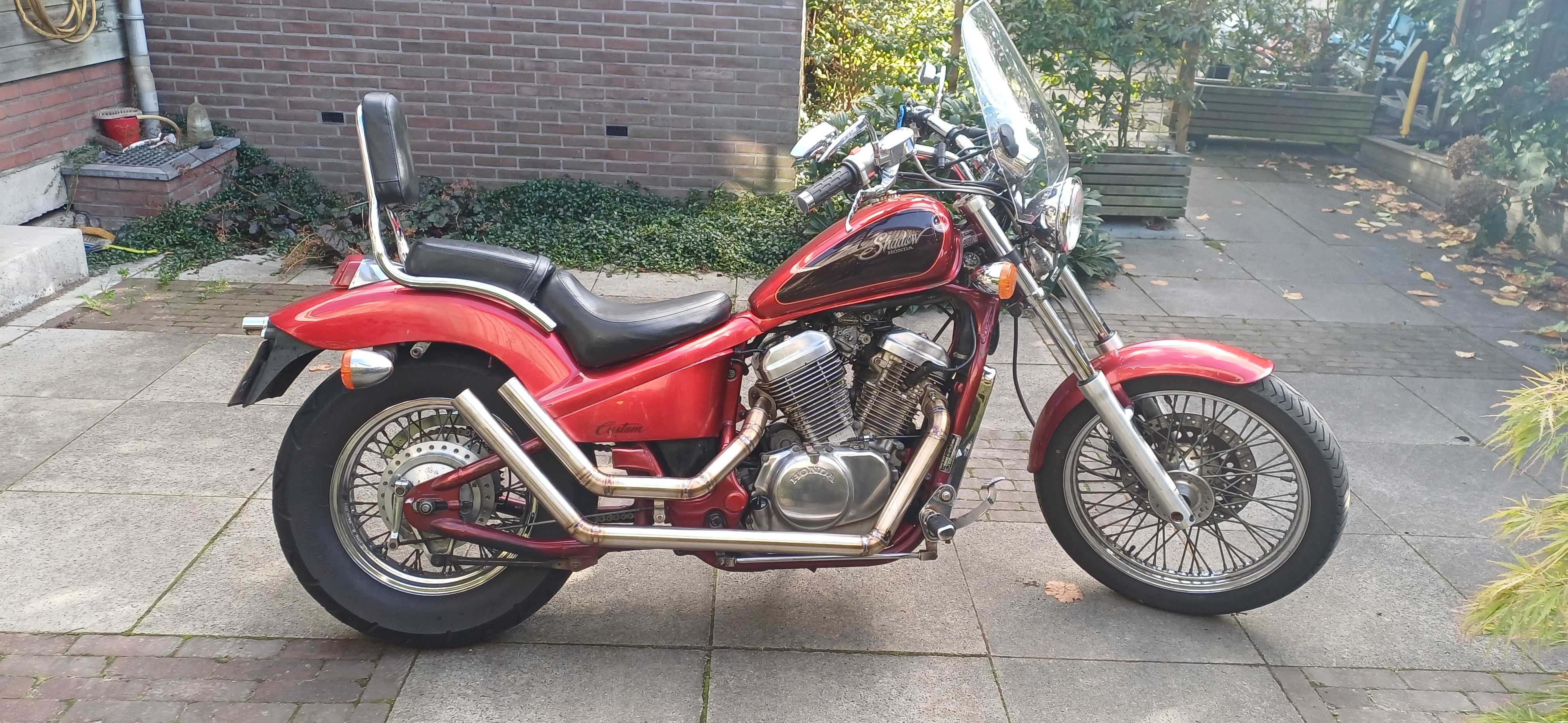

  • I'm Solomon from Amsterdam, the Netherlands, and this is my hawg.
    https://cdn.discordapp.com/attachments/207195280406216704/1559284561609883789/20261001_155630.jpg?ex=6ace8469&is=6acd32e9&hm=81514e081efcbab24a44fb3d895e7de986749013c93340d8c7fb99e08c7a238f&

    i park the bike in my front garden
    Then I notice something.
    There's a single drop of yellowish liquid on the case that sits under the engine. My first thought is coolant, but the new coolant I put in is red...
    Hmm.
    I take a closer look around the bike and notice that one of the fuel hoses, the one with the metal coil wrapped around it, is wet. Upon further inspection, I discover that one of the carburettor float bowls is leaking slightly.
    Interesting.
    Could that also explain some of the fuel consumption? And could the leaking float bowl have something to do with the tuning issues? I don't know yet, but it's definitely something I need to sort out before doing any more testing.
    So, here's the game plan for the next round of wrenching:
    • Buy two new float bowl gaskets to replace the ones that have been giving me trouble.
    • Consider trying a smaller main jet, going from a 142 to a 140.
    • Replace the old, presumably 1992-original carb boots with the new ones I've already got.
    • Investigate the high-throttle behaviour properly instead of just assuming everything is running too rich.
    My current setup is:
    • Exhaust: PTW Custom Shop upsweeps, essentially free-flowing with some fiberglass wool packed inside.
    • Intake: TJBC velocity stacks.
    • Main jet: 142.
    • Needle shims: 0.
    • Pilot jet: 45.
    • Air-fuel mixture screws: 2 turns out.
    I'm also wondering whether I should change the pilot jets from 45 to 42, but I'm not going to start throwing more parts at the problem without figuring out what's actually going on first.
    For now, I'm just happy that the bike is finally getting somewhere. She's loud way too loud for the dutch DB limits I'm thinking, still needs work, and clearly isn't running perfectly, but at least I'm starting to see some progress.
