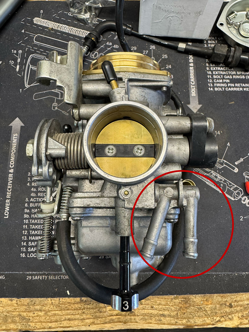

  • My new carb looks great all cleaned up and put back together with the Velocity stack, brass cover, TJ adjustment knob, (and soon the shorty choke that just arrived). I can tell inside and out, this is going to run great.
    However – I can't seem to get this "V" connection coolant thing off though. I don't want to break anything, but it seems like it's pinned in – but I can't see where. Any ideas? do I just need muscle it more, or wedge a screwdriver in and force it out?
    Thanks for any input.
  • @Bry Guy 007 its not pinned in, its just got o-rings holding it in. if you want to leave it it wont hurt anything. You can twist and pull on it and it will come out. =)
