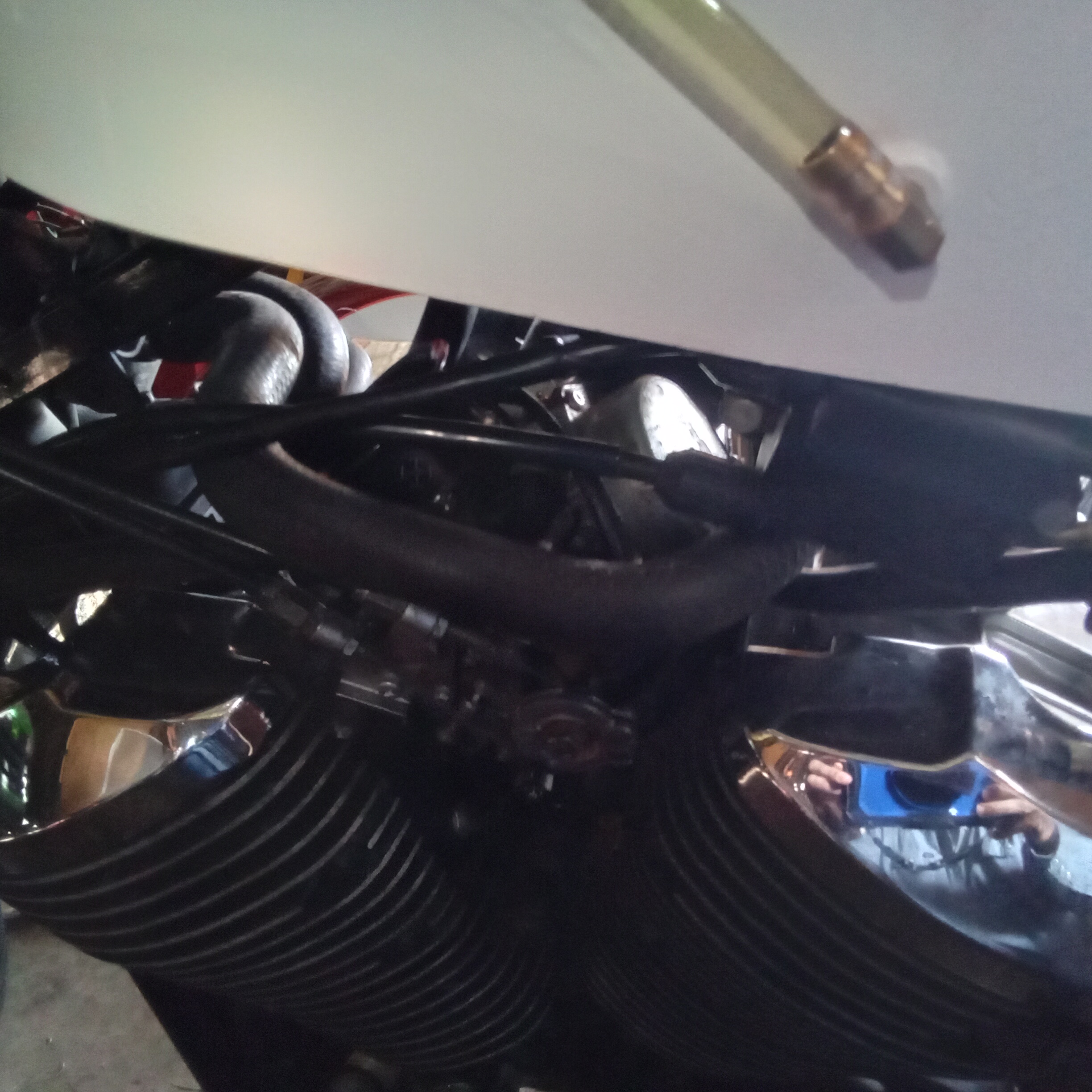

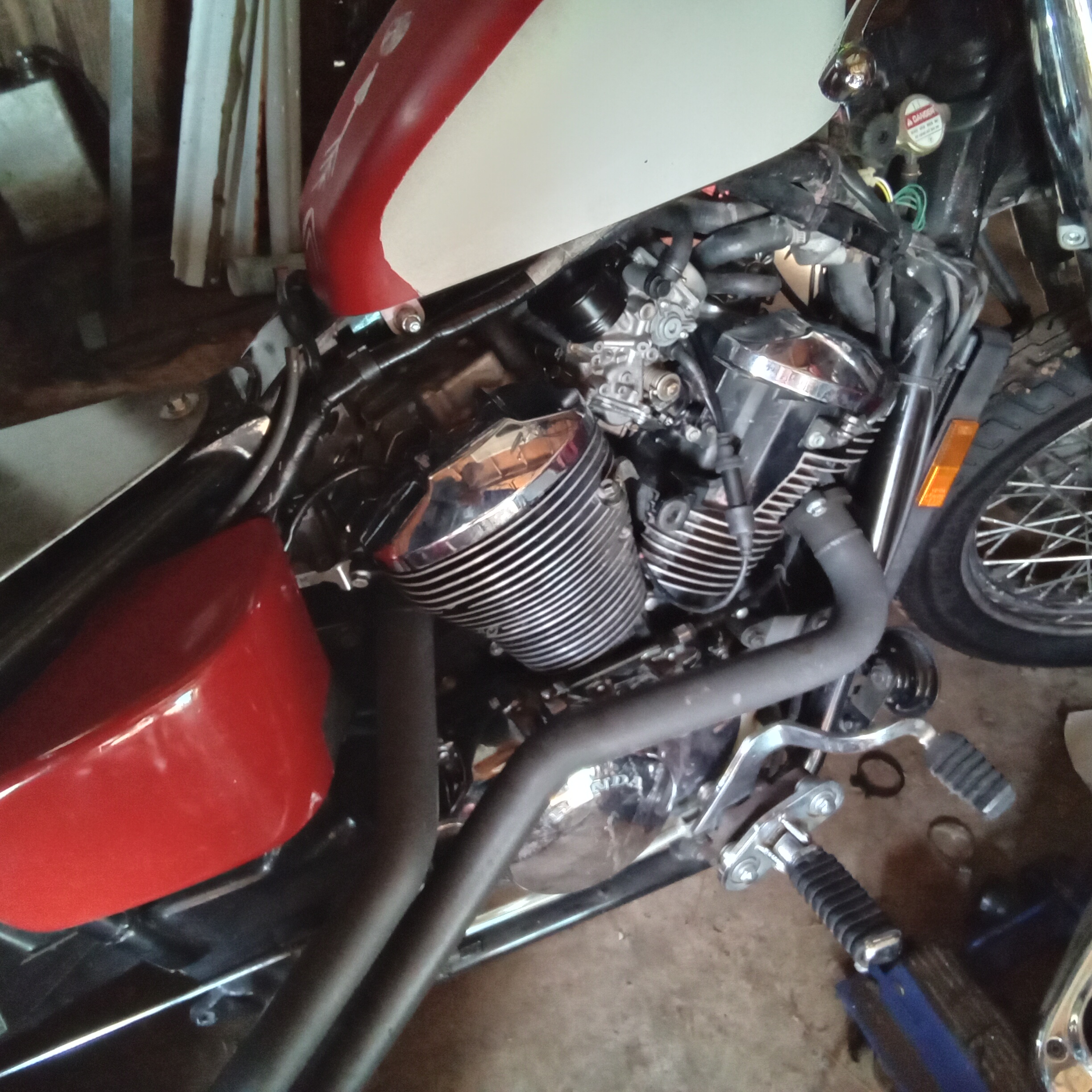

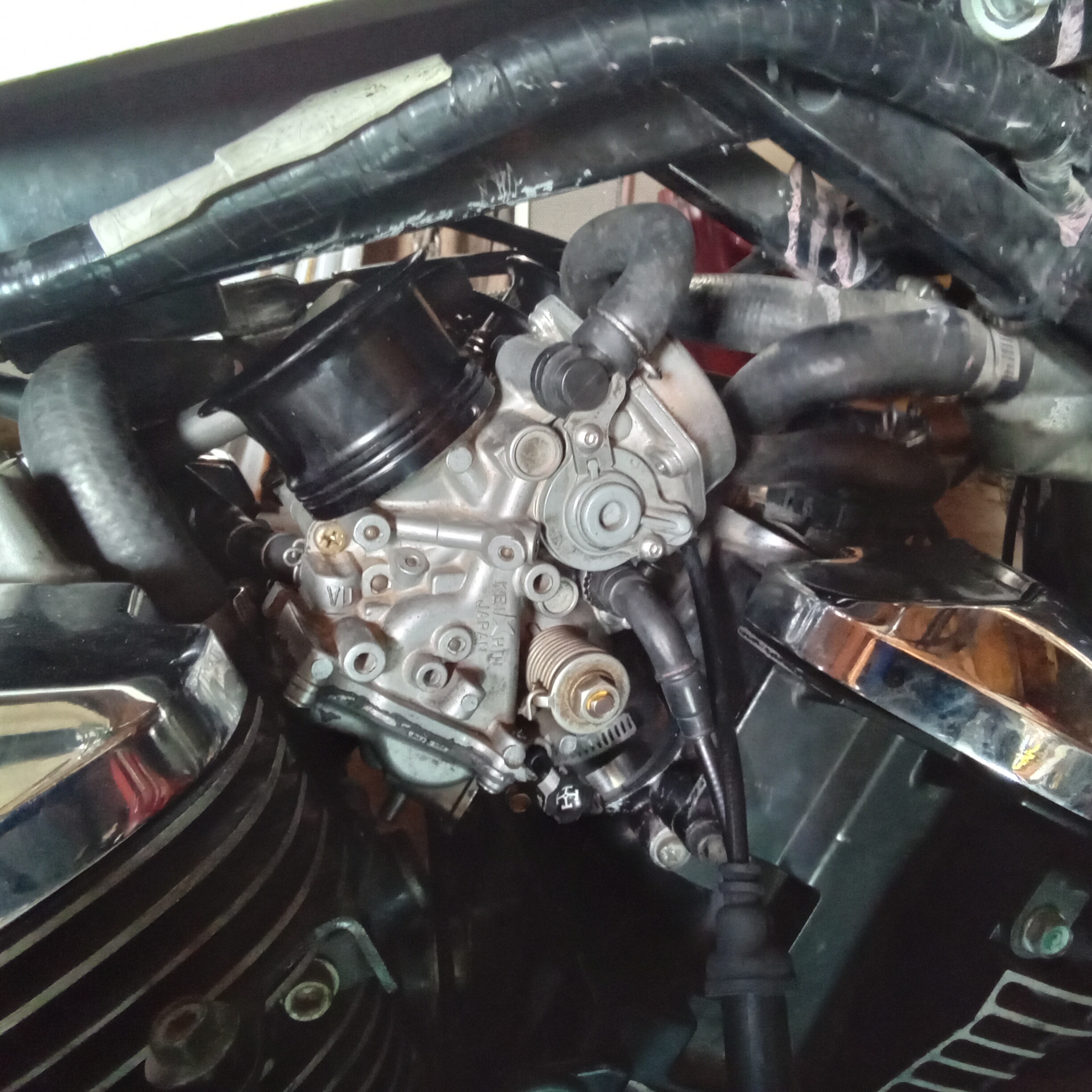

@Mr.P post a picture of what you plugged and i can look at whats going on
The only 2 ports that I have plugged are the 2 at the left and right of the carburetor intake that join and t into the one hose that goes to the air box. I still have the slide diaphragm vent hoses attached and joined to the plastic piece that likes to pop apart when you look at it too closely. I am planning to get the vent kit. And I have the crank case vent routed down and left open to breathe. Zero vacuum leaks. Cleaned the spark plugs. They were black like too rich.
@Mr.P i need to see which ports because if youre blocking your slide vents then thats a real problem.
Thanks for responding. I definitely don't have the slide vents blocked. I still have the factory hoses setup on them. The ports I have blocked went to the air box.

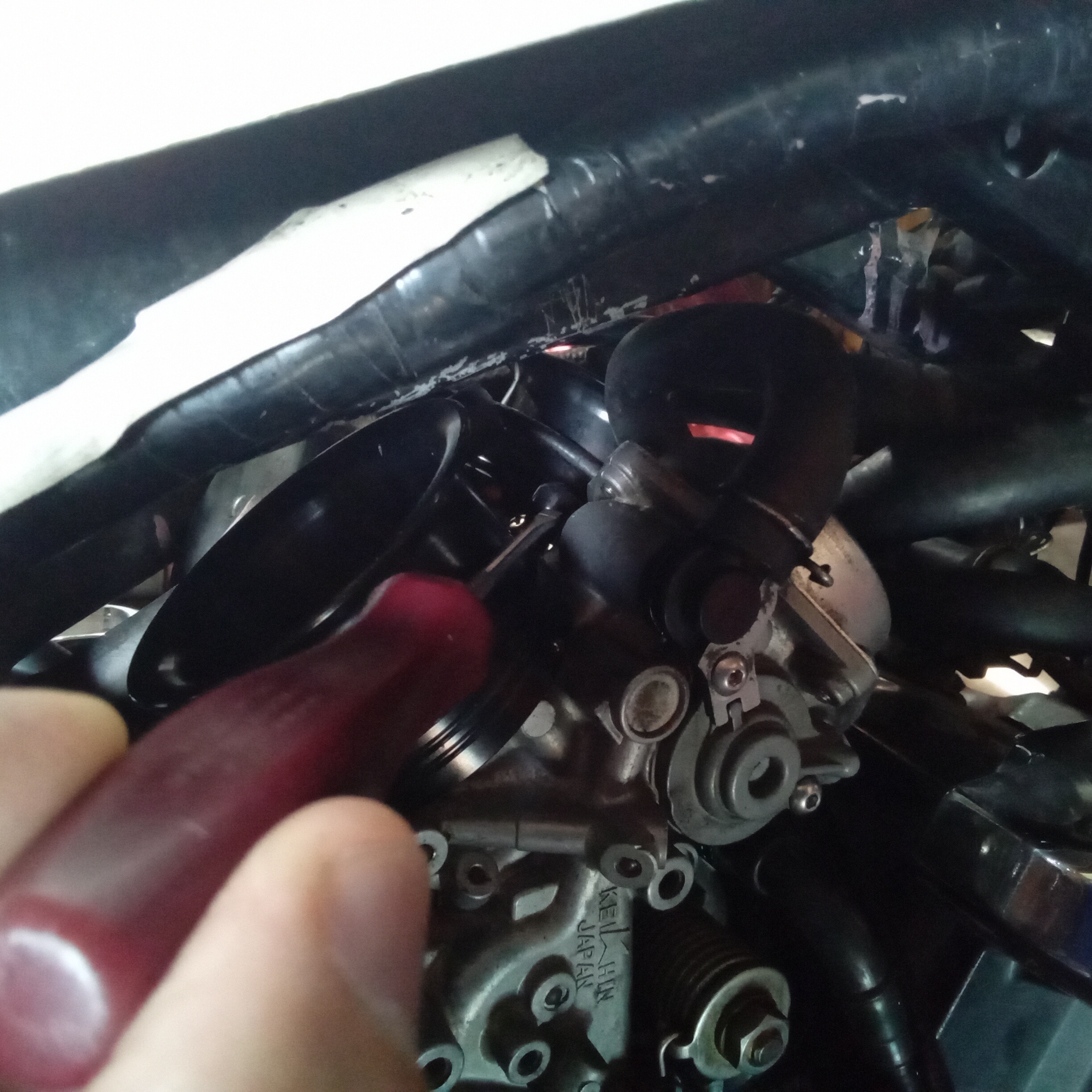

The picture with me holding the screwdriver I am pointing to the cap over the vacuum port
