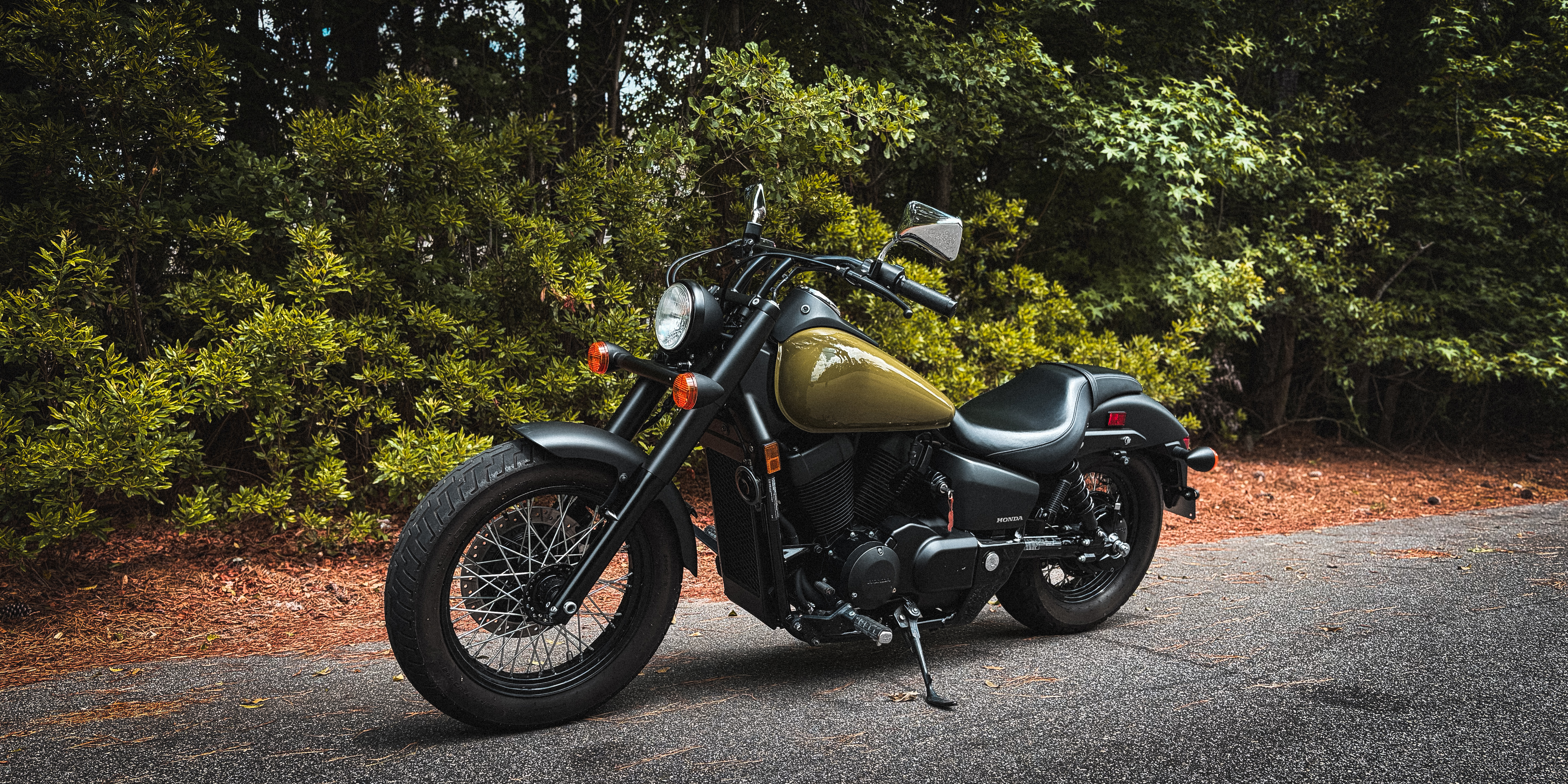

    Here's a shot of my bike (I added EZRizers and TJBC bushings after taking this pic)
