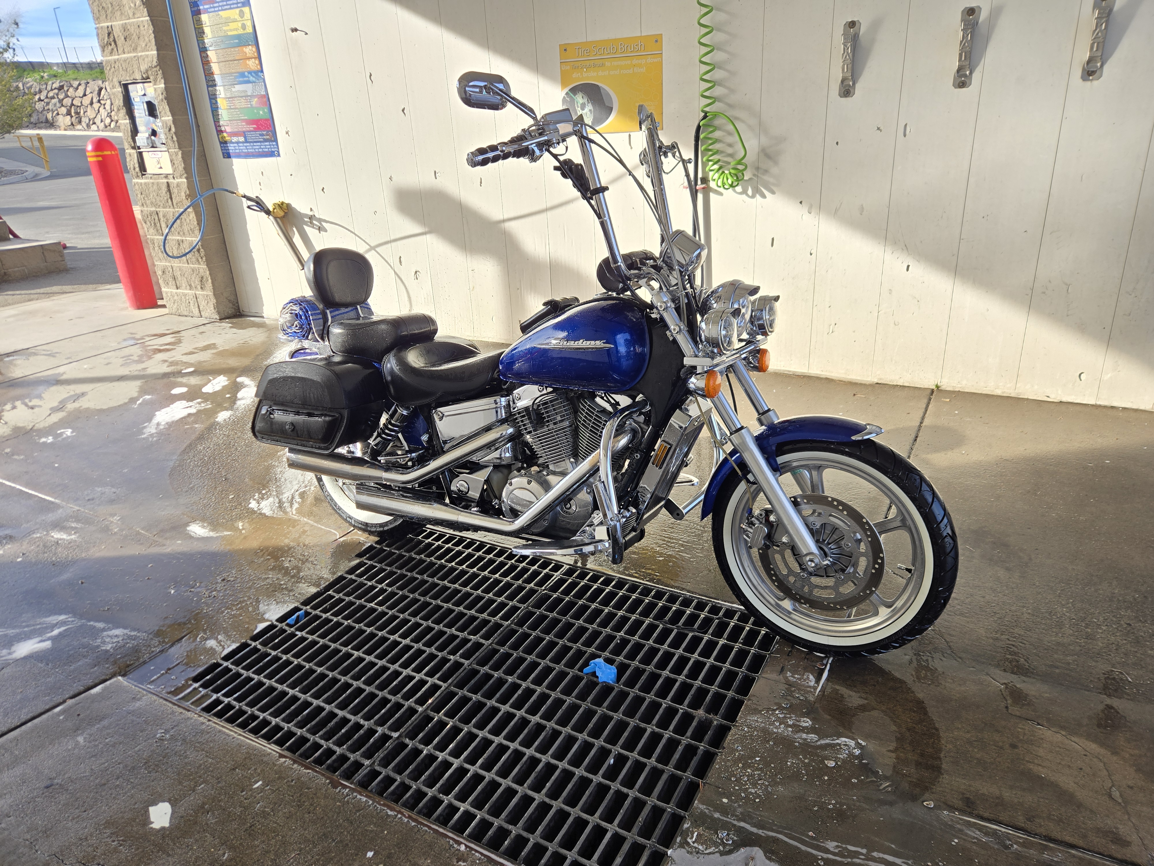

  • Hey quick update on my bike, I got the spaghetti delete done and Im happy with that. I got the velocity stacks in and the bike almost tuned up 100%. So currently I have the 198 main jet and no shims. The bike does really well around town but it does seem slightly slow in the mid range of throttle. It also tops out if I go to wot. I was going to put the 200 jets in and probably one set of shims for the needle. My question is; is it better to have access to more fuel or less? Like I said the bike runs great now but seems like it could use alittle more. Any help is appreciated. Also side note I think its super cool that TJ responds to these and actually helps the community out. He is not just a guy who makes YouTubes and sells parts, he seems like a genuine dude. I would love to run into TJ at a bike meet or meet him at a bar.
  • @Jesse Bolson hey dude bike is looking solid! The 1010 is a torque machine, not a top speed demon. around 4k that engine is making the best torque and then things flatten out. tuning just means getting the bike to perform ideally wher eyou want it to without being too rich or lean. you can tune a drag bike to run really well at WOT but not so great at idle. make sense?
