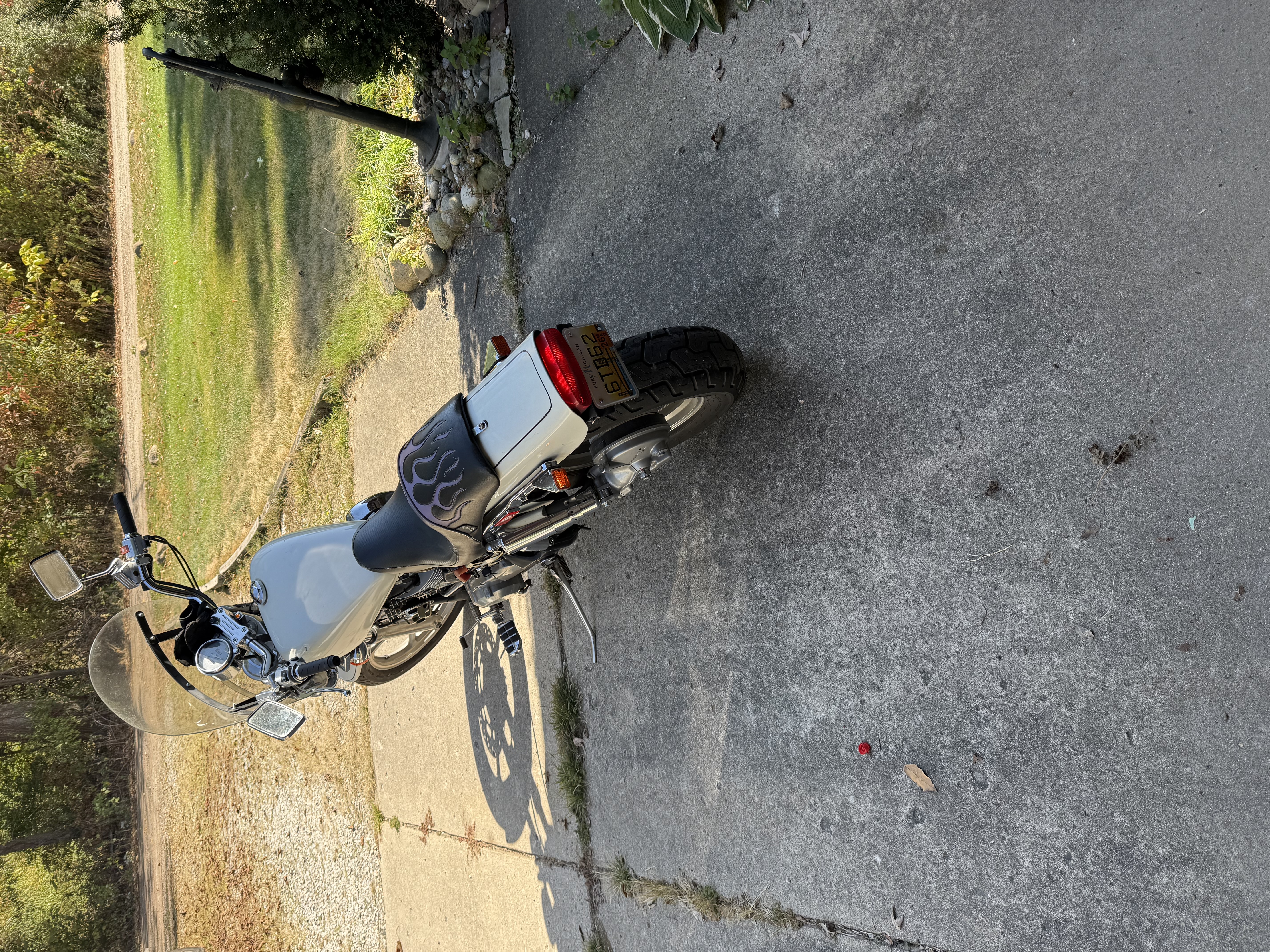

  • I have a 1994 Honda shadow 1100. It has cobra drag pipes on it. It runs bad around 65. I bought it in a auction not sure if the carb has been re jetted. So I bought the complete performance rebuild kit. Going to keep the stock air box because I'm on a budget. But was wondering if anyone had any suggestions on what jets to install. I haven't gotten the kit yet. I live in Michigan. Really just want it to run better and cruise better on freeway. Don't want to have to keep swapping the jets around. Thank you.
