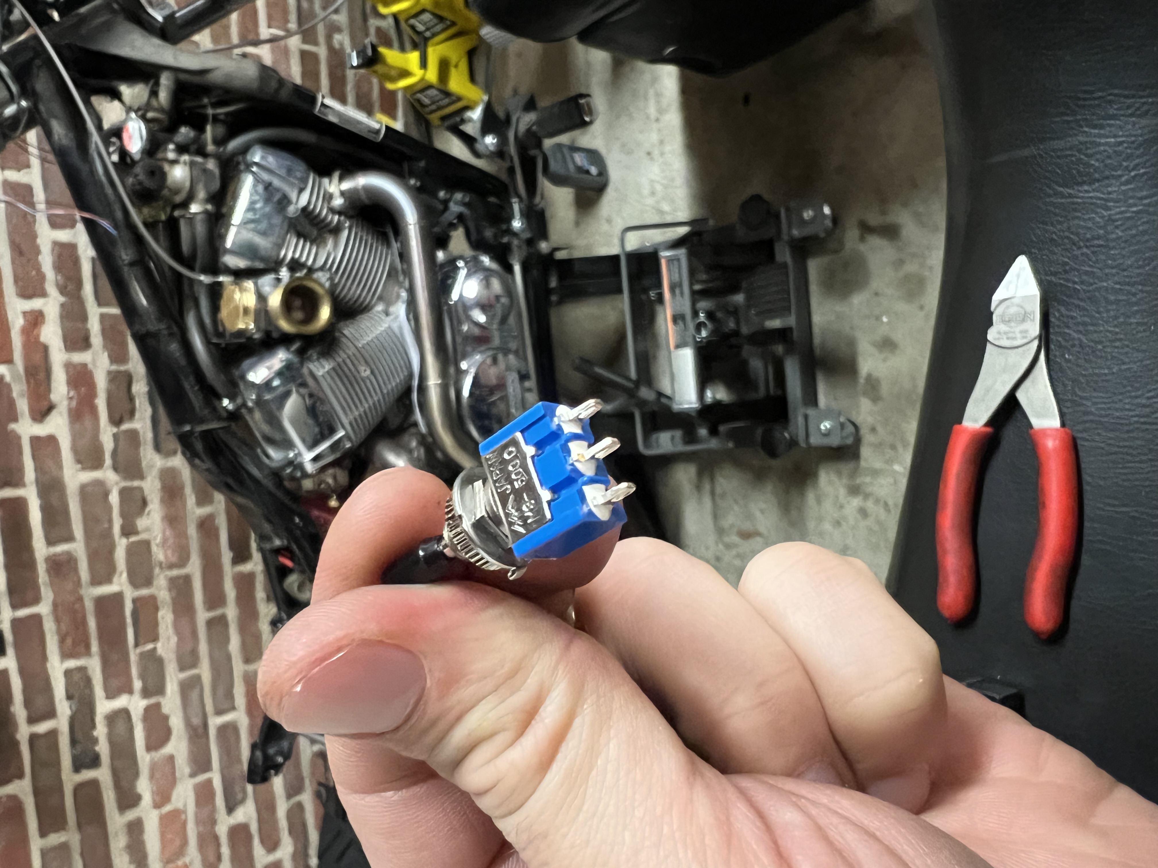

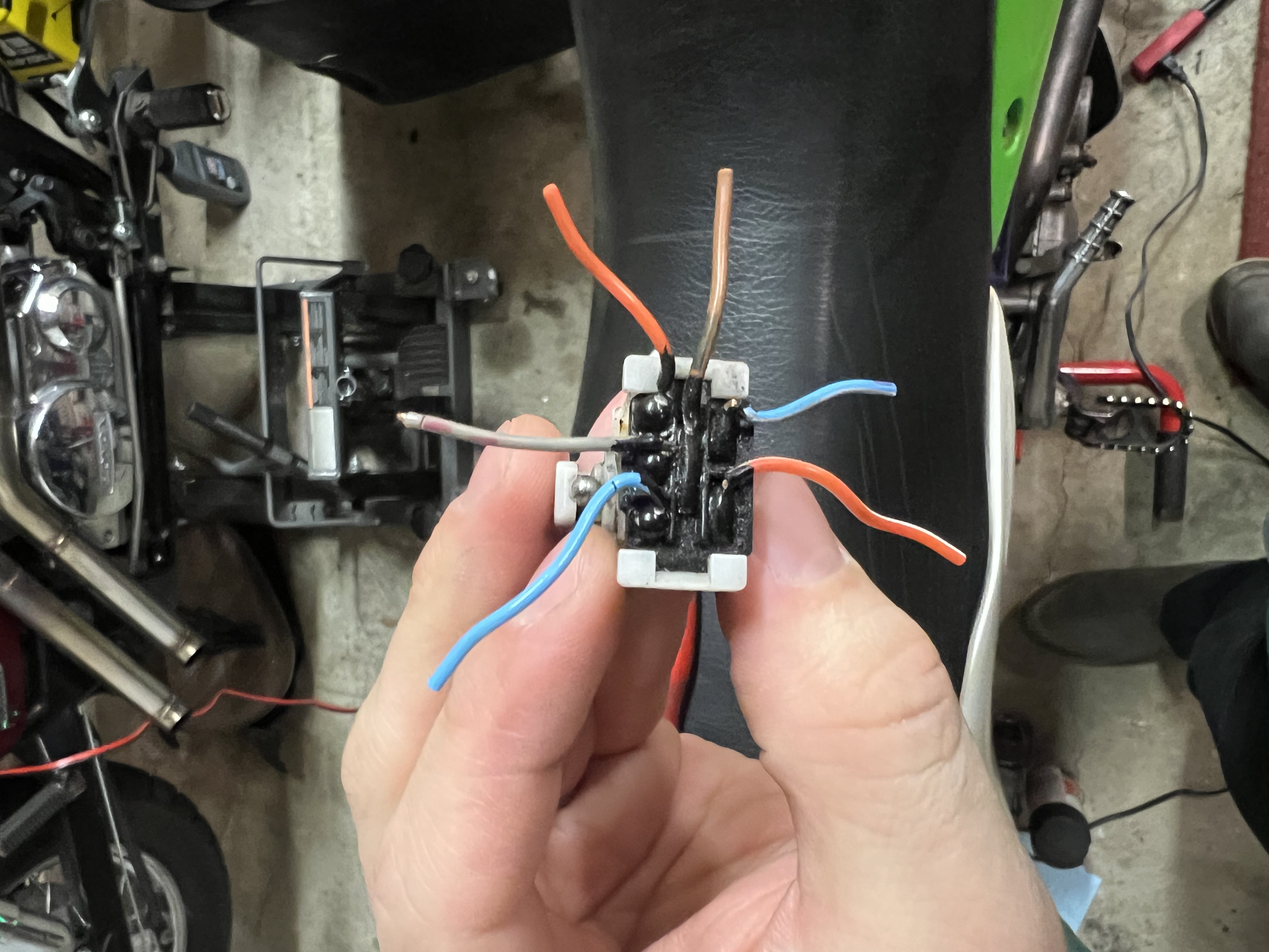

  • 2005 Shadow 750 Aero: I'm replacing my handlebars and going with all custom switches, the last 2 things to figure out are the headlight and turn signal switch. I'll be using a 3 prong switch and no longer running the OEM odometer and lights. Which wires do I need to be running to the switch?

  • If you are not using the running lights, you only need the top row.  Solid orange and solid blue are the signals. don't remember which is right and left, and the gray wire in the center.  the striped ones are your running lights.
