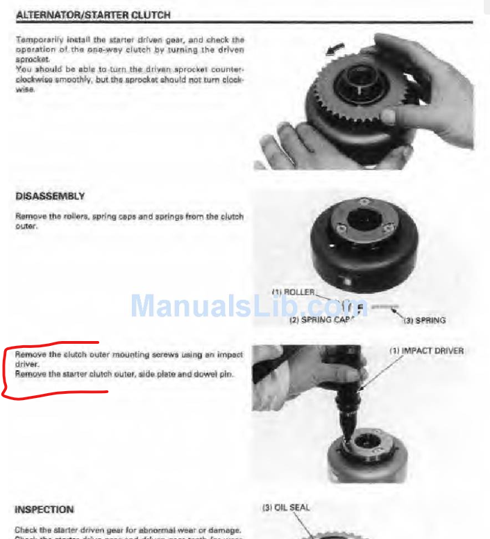

  • OK, got the rotor out of the bike, no problem. Issue is the clutch won't come off the rotor. The three screws came out ok (impact wrench for the win!) but it won't budge! It looks like there is a cover of some kind (saw mention of it in an online copy of the manual but can't find it again to reference here) but can't see how it is attached.
    Worse case scenario, I will just get the old springs and stuff out and replaced with what came in the new set.

    Finally found that manual reference that mentions a cover but doesn't show how it comes off (other than the 3 screws).
    https://www.manualslib.com/manual/1232303/Honda-Rebel-250.html?controller=view&page=137#manual
