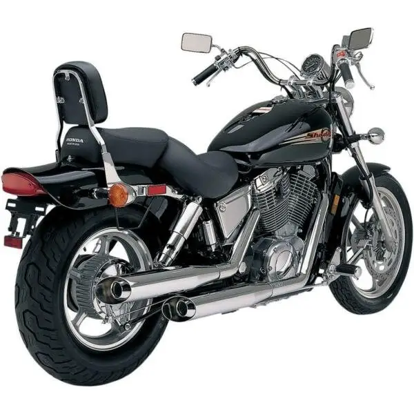

  • Recently purchased 2002 Honda Shadow Spirit VT1100C-A. Somone installed these Vance & Hines aftermarket exhausts w/baffels. They kept stock Air Cleaner, and stock carb setup. It runs, but front Cylinder Pops (Afterfire) and bogs a bit when gunning the throttle 2-3 gear. I'm trying to get the spacific model # for these pipes, to know how to re-jet the Carb for them and a K&N air cleaner. I haven't pulled the carbs yet but plan to do a full clean and rebuild. Stock Dual Carb jet set up should be (Pilot #42 - Main #178). I'm not sure if I need #40 pilot with #180 Main, or leave the Pilot at #42 and just do #180 for the Main. Or even stagered pilot/main jets for front and rear carb. Can someone help me with the model number for these Vance & Hines pipes, and the particular Stage One jetting for the Dual Carb setup. Southern Cali - desert - so very low elivation......below sea level. Thank You Greatly.....
