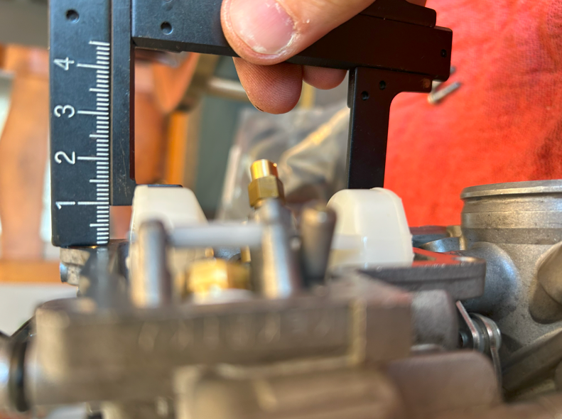

    I watched this youtube video that went into detail adjusting a vt1100 carb. I purchased the little tool off of amazon, less than $20, and I measured my floats. They were WAY OFF! They're supposed to be at 9.2mm. My rear carb was at 15mm, and my front carb was at 13mm. No wonder I was running lean. No amount of jetting would fix it.
    I moved each metal clip about .2mm and I was able to get it to 9.2mm within about +/- .2mm. What a difference this made!! The bike runs better than it ever did.

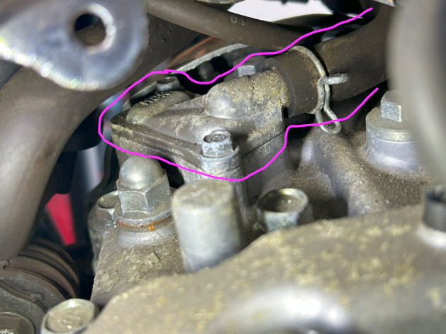

    Adjusting the floats however didn't address the decel after fire popping though. What fixed that for me was capping the stupid california tree huger PAIR system. Introducing fresh air into your exhaust is what causes the popping. Exhaust leaks can as well, but with fresh exhaust gaskets (MAKE FREAKING SURE TO REMOVE THE OLD GASKETS WHEN CHANGING THEM) I didn't have an exhaust leak. After plugging the PAIR valves, the popping was reduced by at least 90% on the Cobra dragsters. There's still a very small amount of popping, but I don't sound like chitty chitty bang bang any more. It was embarrassing. Here's what the PAIR valve looks like on my 06' VT1100C2 Sabre:
    Remove the vacuum line, and cap it. There's one on the top of the front and rear valve covers. Use a high temp cap. You can also remove all of the plumbing involved in the PAIR system. There's quite a bit of it. I couldn't find any plates for a vt1100 to block off the system, so a cap will have to suffice.
