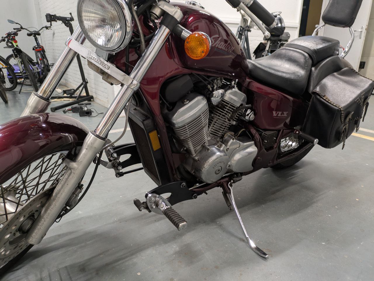

    Like the title says, I am debating whether or not to get myself a set of forward controls for my VLX600.
    For some context: I stand at 6'3" with a pretty standard 34" inseam.
    I like the bike a lot, recently did a 300 mile weekend trip with nearly 10 hours in the seat and it was an absolute joy.
    However I couldn't help but notice that after these sorts of hours in the seats my knees and hip started complaining.
    And the fact that my foot has to bend over backwards to brake without lifting my foot off of the footpeg (not a huge deal imho).
    I could adjust the brake lever but that would create a lot of travel which im not super keen on.
    So I have been contemplating whether or not it would be a good idea to install forward controls and if so by how much forward.
    I do have a set of highway pegs  on the bike attached to the engine guard, which helps but isn't entirely ideal either.
    I tend to stretch my legs and lay them on my main pegs rather than use the highway pegs, but due to a lack of support under my feet I slouch in the seat that way, which is also, less than ideal haha.
    My main concerns with forward controls is control of the bike.
    Would love to hear Y'alls thoughts, picture of the bike for fun:

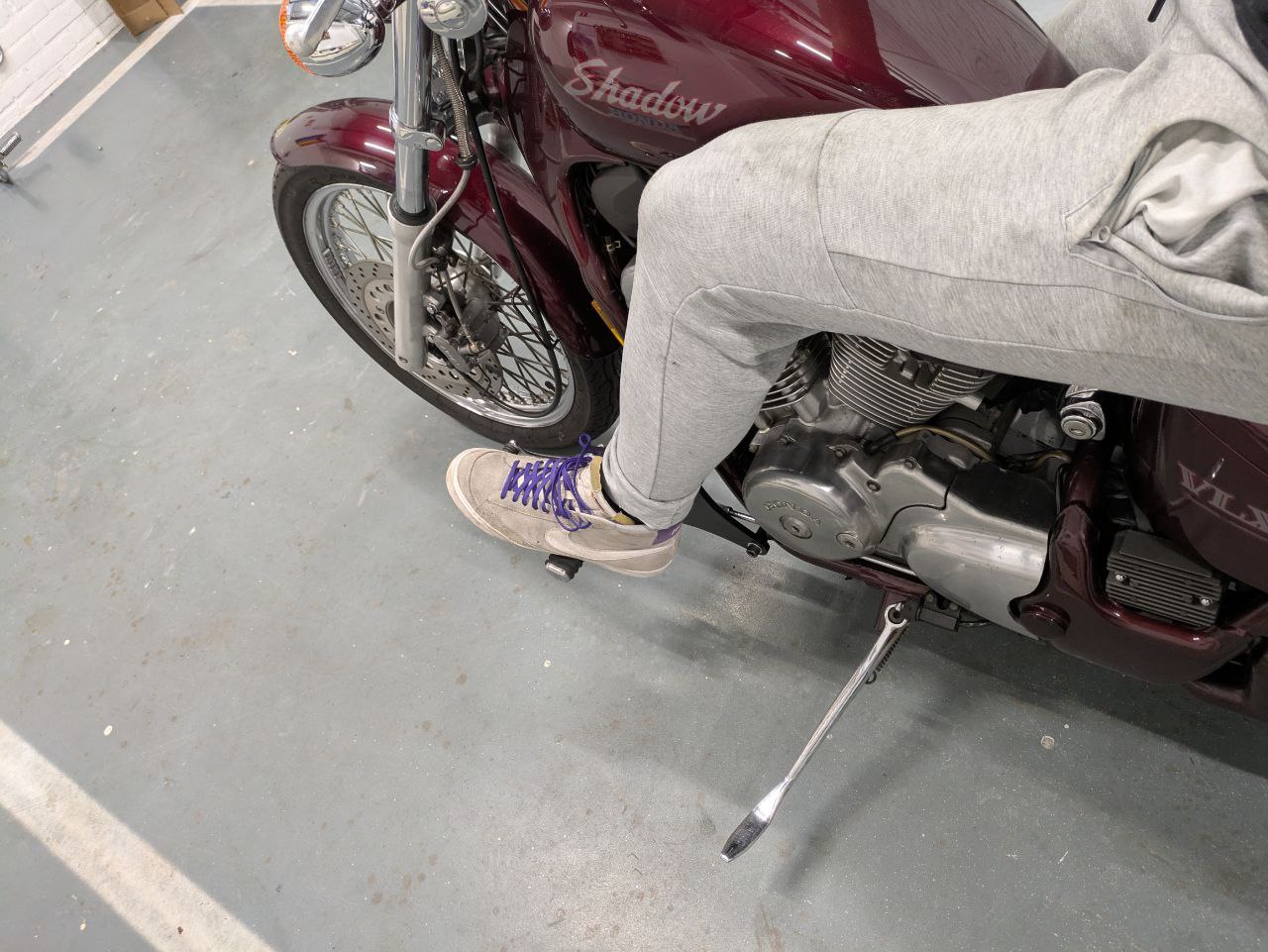

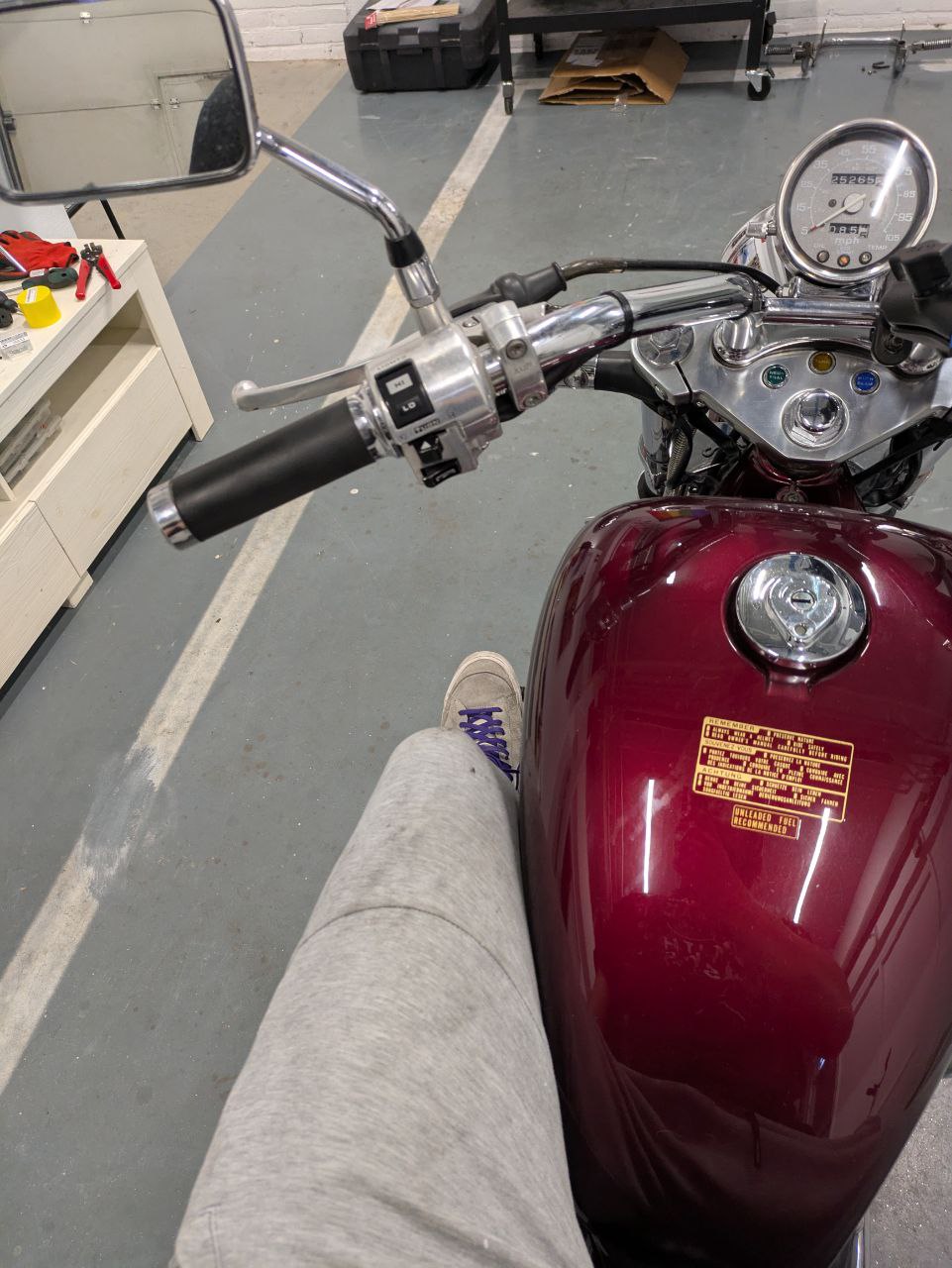

    Here's a side by side of the difference with my height and inseam.

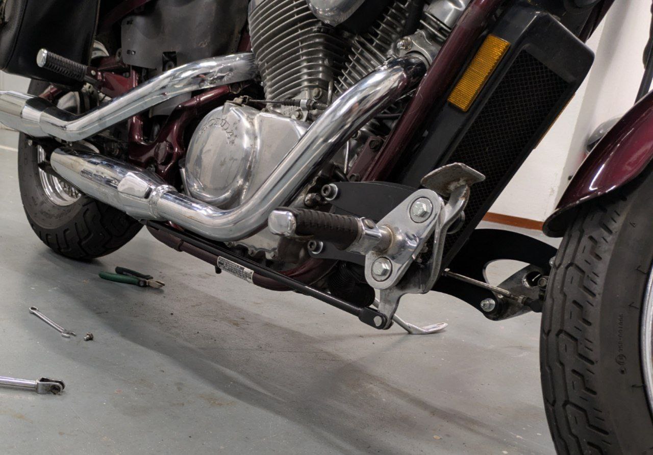

  • Heya @TJ
    The forward controls came in and so far so good, the weather has been utter dog water so I haven't been able to try them too much, but I did get a short ride in.
    It feels very different and definitely something to get used to, but it sure is comfortable!
    I also managed to adjust the rear brake pedal, took me a second to figure out that it's just a small bolt in the pedal that acts like an endstop haha.
    But yeah, so far so good, I look forward to making some more miles on it and seeing how it works out.
    These are the ones from scootmods, installation was relatively easy all things considered.
    The most difficult part was the mid brake rod rear bolt, holy shit that's a difficult one.
    Doesn't help that the only included instructions are a written walkthrough with pretty basic: this goes there, that goes here, you'll figure it out!
    I should do a video overview of these to help people when installing them to be honest.
    some photos:
