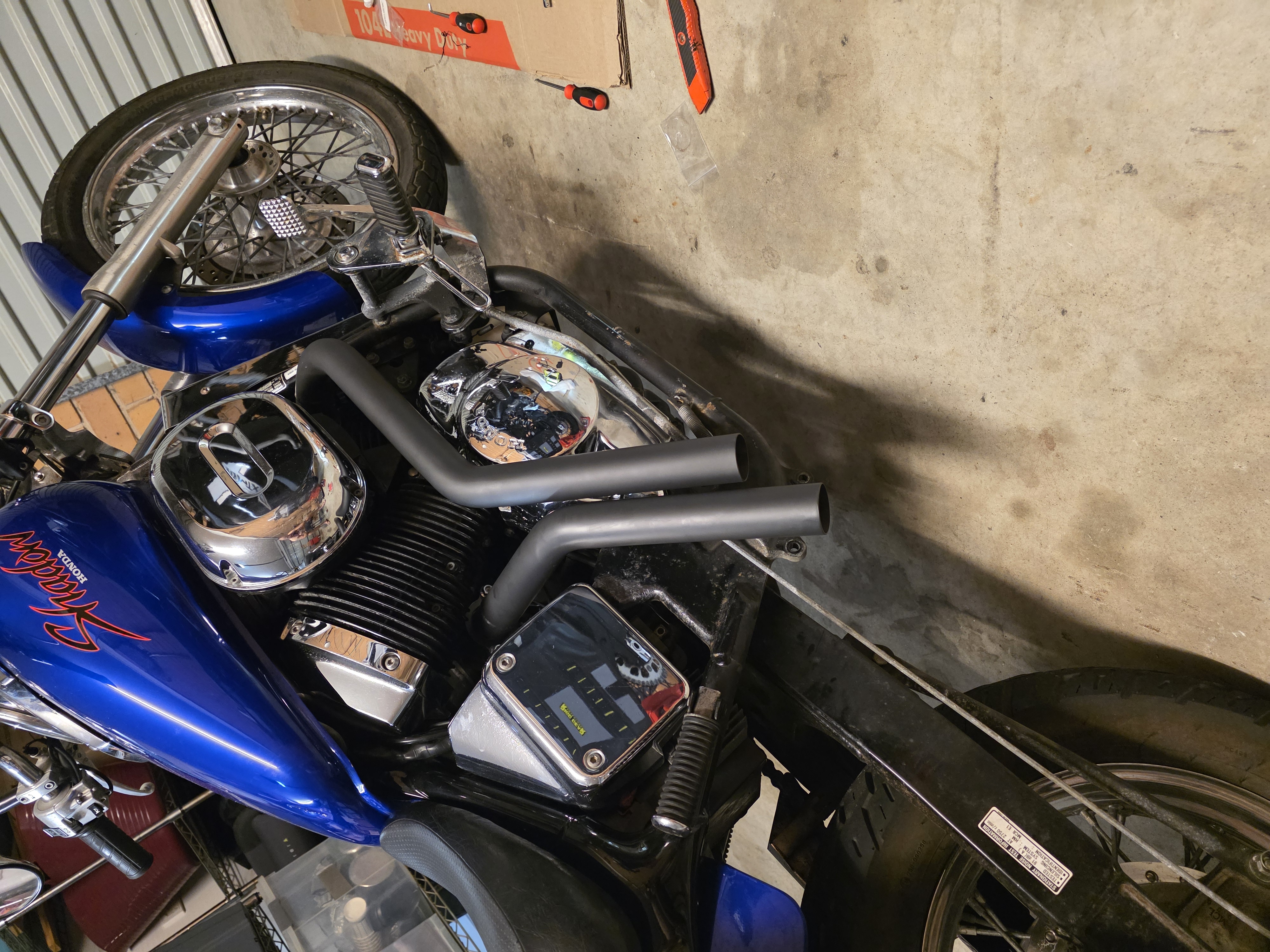

  • Man iv been having problems with the tuning on this bike!
    Iv installed the perfomance kit.. Intake stacks and short pipes now the 750 isnt liking life atm.
    prop's im having now are popping at idle and insane amount of decel popping.
    current carb set up 2 washers under needle 152 main jet and 45 pilot 2.5 tunes out from bottom on air/fuel. current altitude is 15m.
    brand new intake boots new exhaust gaskets iv also removed all the emissions BS from the bike and pluged everything up on carbs as per videos, im yet to check/replace spark plugs.
