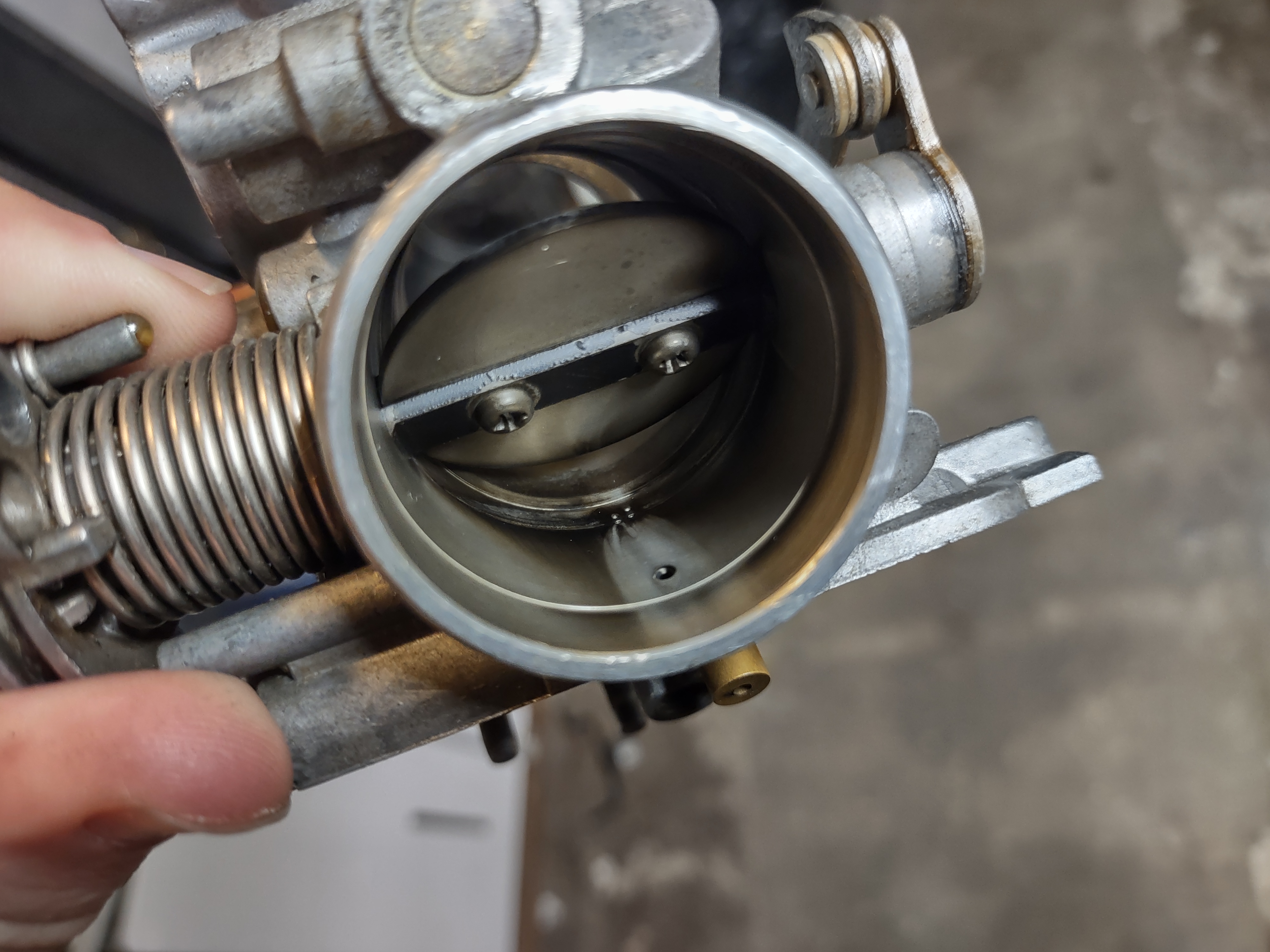

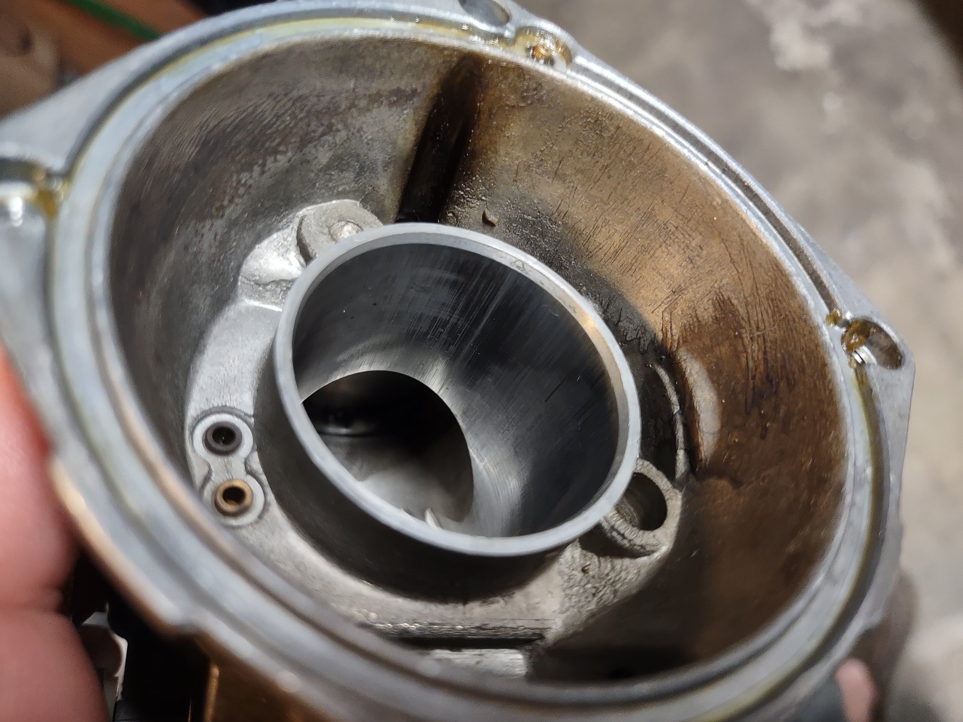

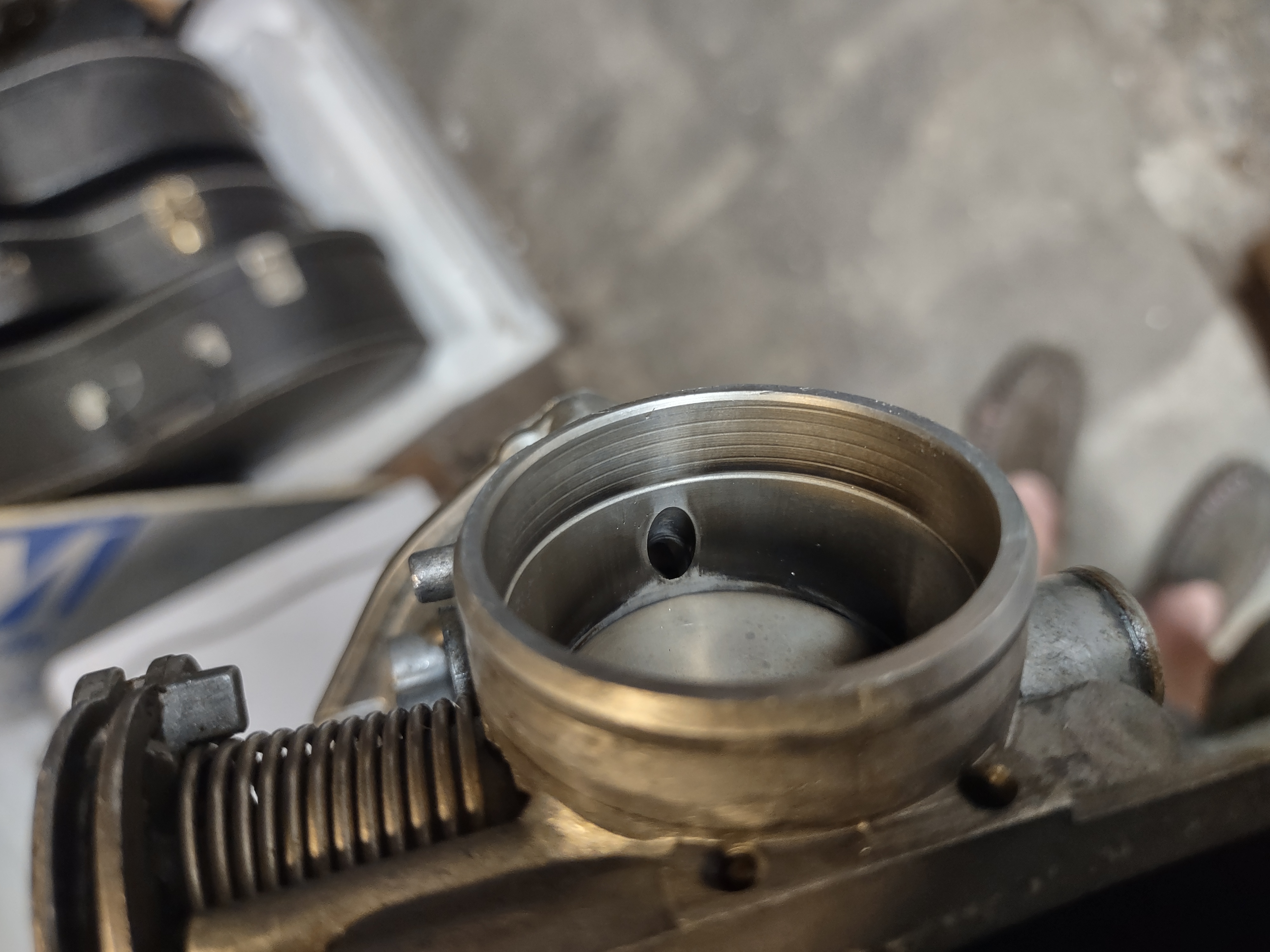

    Oh.  Also, there is a burn pattern behind the butterfly valve on the rear carb (leading to the cyllinder), with the smoke residue going up the port into the diaphragm chamber.  No, I was not smart enough to keep the jets separate when cleaning and can only assume the weird jet was in the rear carb.  Would a lean mixture lead to scorch marks in the carb?  Backfiring in the intake?

    Carbs look(ed) squeaky clean EXCEPT for two things: 1) There was a burn pattern in the throat after the butterfly valve (leading to the cylinder) with some smoke also running up the port into the diaphragm chamber.  2) There is something seriously wrong with one of the pilot jets.  (I was not smart enough to mark which was which so not 100% sure it is from the blackened carb)  Looking from the top, no daylight.  Pass a guitar string through it from the top, now you can see through.  Turn it over - no daylight.  Try to pass the wire through - it gets hung up a few mm from the top.   Turn it over - no daylight.  Pass the wire - daylight.  Cleaning had no effect.  I looked at it under the microscope and could not see what the issue is from either end.  I cannot figure it out.  I was under the impression that the passage in the jet (the .42mm part) was just straight through, but it feels like there is a cavity in the middle with something moving around.
