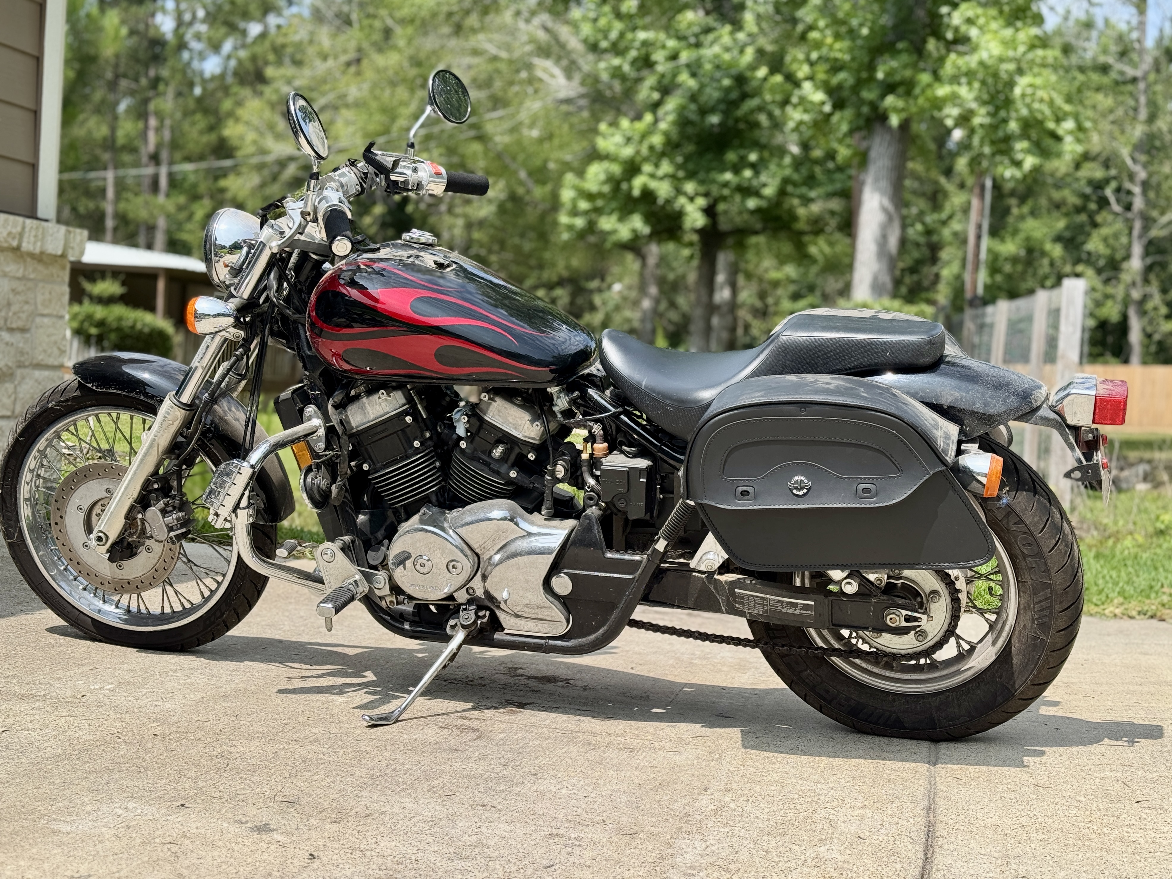

  • The name is Austin, I'm from over here in the Houston area. I finally got my first bike after years of looking at getting one. Super stoked, but it needs some work. A friend of mine has had this sitting in the garage for a few years and we found out he was looking to just get it out and had been calling around for someone to just come and scrap it. Now it's mine! For "free"! It's a 2005 VT750DC, and since I've always been into the bobber style bike I ended up here after looking at what could be done to customize the bike.
    It had been sitting because he had some carb issues and when trying to fix it one of the jets was stuck in the threads. So he said I should only need to get a new one to get it back up and running. He had gone at the jet with a wrench and blowtorch so it was pretty fucked. I was hoping I could get it out and just do a rebuild of the carb but I actually made it worse and cracked the housing, so unfortunately learned some lessons there, and didn't make anything better. Searching around for an OEM carb now.
