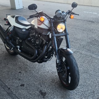

  • Short version:  I bought a Sportster frame, and I want to build an engine with the best combination of parts to get the best performance.  What would you suggest?
    Long version:  I bought an XR1200X a few months ago.  Low miles, bone stock, later model with the floating front brakes.  Love the thing to death, even took it to Tail of the Dragon one day and had a blast.  And I wanted to do a little wrenching on it, but the more I thought about it, the more I realized that my bike probably should stay just the way it is.  It's a great example of one of my favorite Harleys, and if something bad happens to it, I might not get another chance to find one of these in as good of shape as I got it.
