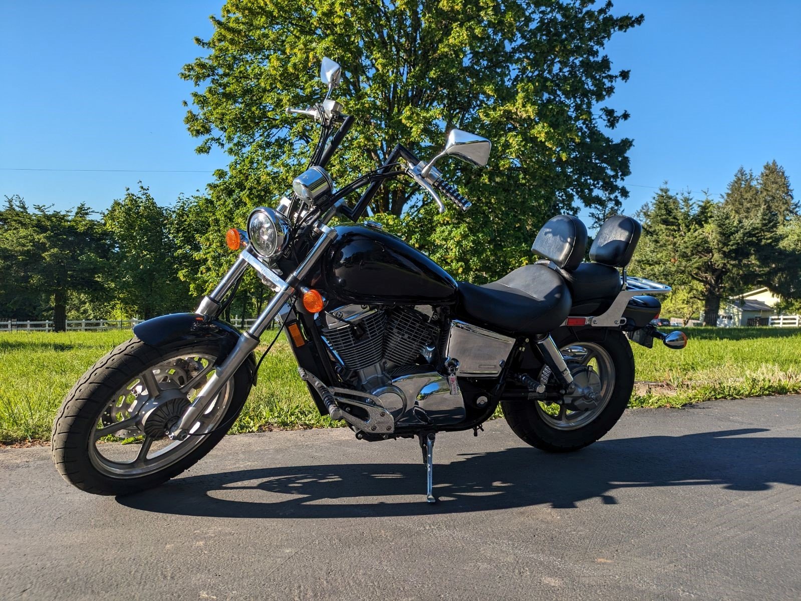

    When I got it home:

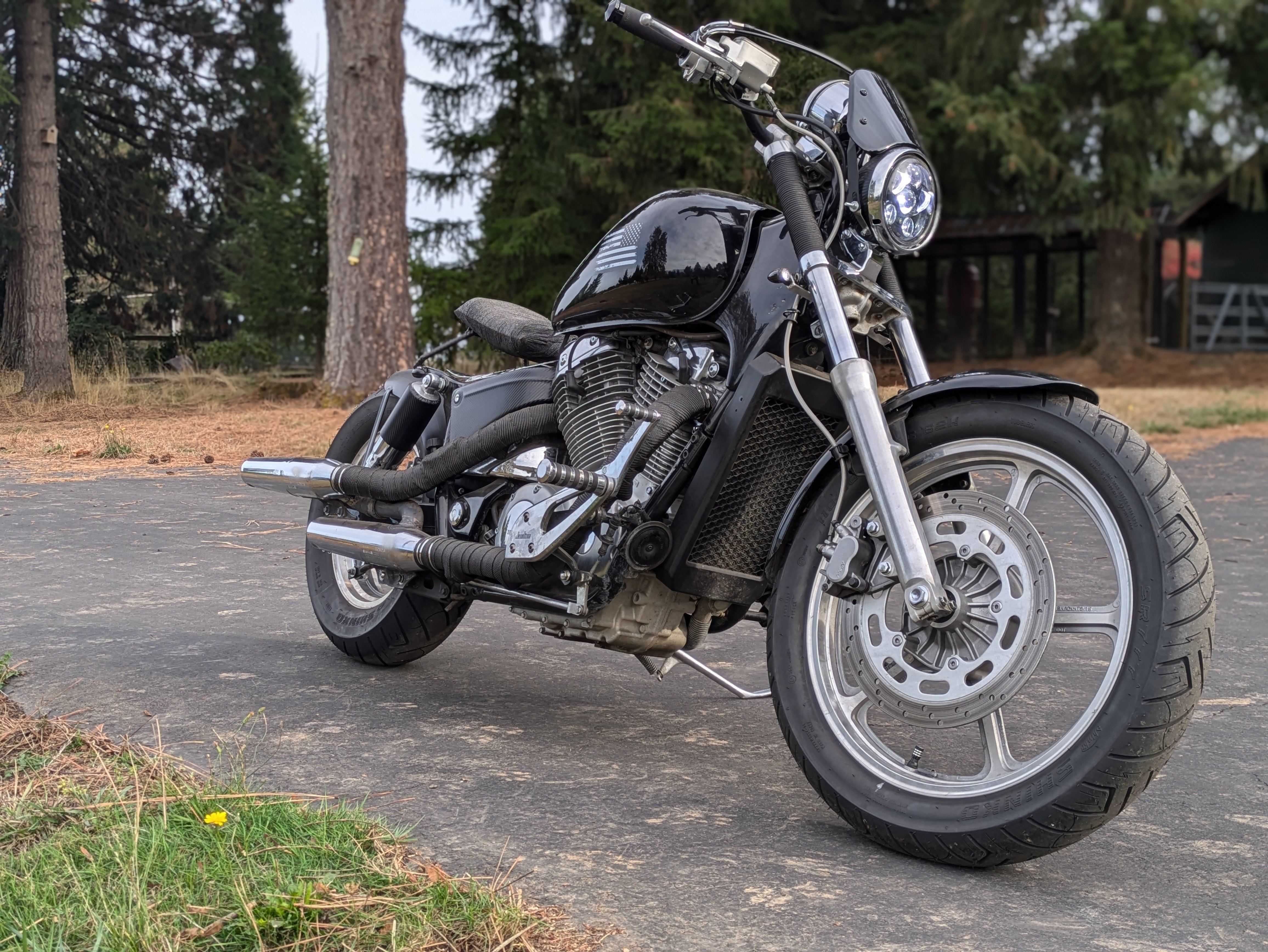

    As she rides now:

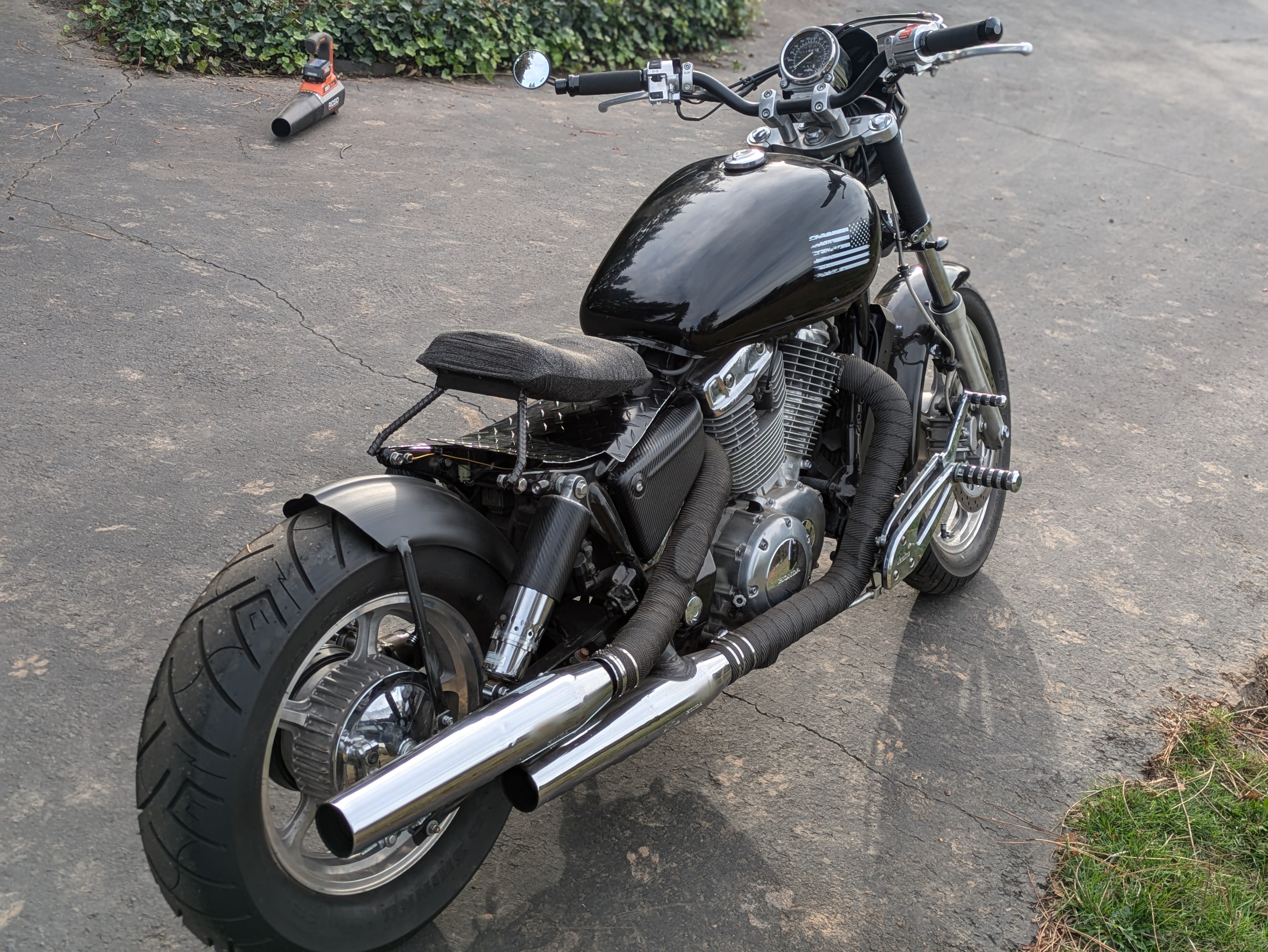

    A few other angles.  TJ's fender... but in Oregon I think I'm going to go for the long version.  I wish I had a video of the rooster tail from the rain but from the way the back of my helmet looks it must be epic.
    Next on the list is the VT1100 kit with the dump out (but I haven't dragged the pipes yet so I'm stalling), maybe a real seat (Harbor Freight makes a really comfortable shovel), and a I think I'm going to paint the wheels which I should have done when I had the wheels off to replace the old rubber.
