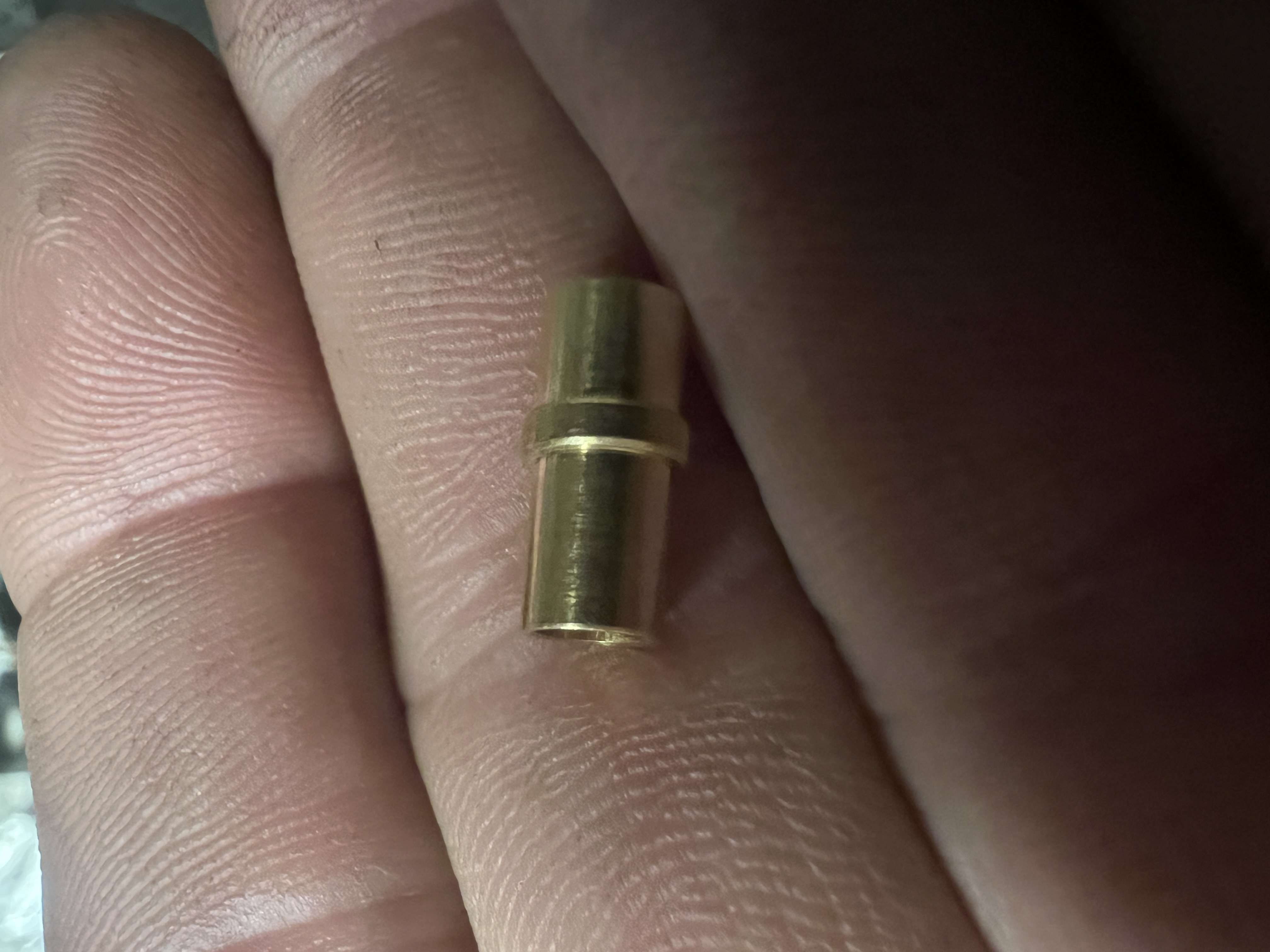

  • Ok i might be an idiot right now..  im done with the carb, and stuck with this.. what is this for? 🙈
  • @Karl Valderhaug That good sir is your needle jet! That goes in the carb body before you put the main jet holder and main jet back in. It is directional too. One end will be kinda flat with a hole, the other end will have a tapered hole going in. The tapered side goes towards the slide.
    In the image below the screwdriver is pointing to the needle jet. the needle goes down into it. but the needle jet must be installed from below when the bolw is removed and the main jet holder is out.
    VTX1300 Needle jet reference
  • Haha offcourse.. feel kinda stupid now but to my defence i was 12 cans down and could barely see straight..
    Got the new one in now 👊🏻
  • @Karl Valderhaug hahah! happens to the best of us when we are hittin those garage beers and workin on a chopper!
